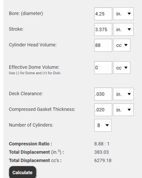

A 383 engine is not a high compression in 1970. If I calculate correct so is has it 8.9:1 with steel head gasket and 8.55:1 with a .039 gasket.
Should be around 9.5 with a steel shim. Felpro will be close to 9; assuming 10:1 pistons for both gaskets.
I don`t think there is such ting as a 10:1 piston from the factory, building compression in a 383 engine is not an easy ting to do with open chambers heads.
All factory 4bbl engines that I know of had 10:1 pistons. As the engines were built they were about 1/2 a point less than advertised
but not in the high eights.
Mopar rated the compression with 79cc heads.
At least, that is what they posted for spec. with NHRA way
back then.
But of course, as cast they were probably as big as 88cc.
Easy job to CC heads and cut them to factory specification.
