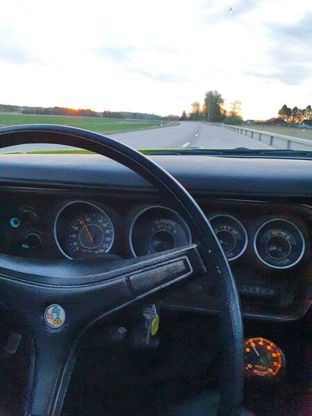

Oh, to toss in another set of data for an example, my GTX has 3.55's and 28" tires (275/60/15).
2800RPM is 65MPH, pretty much dead on.
