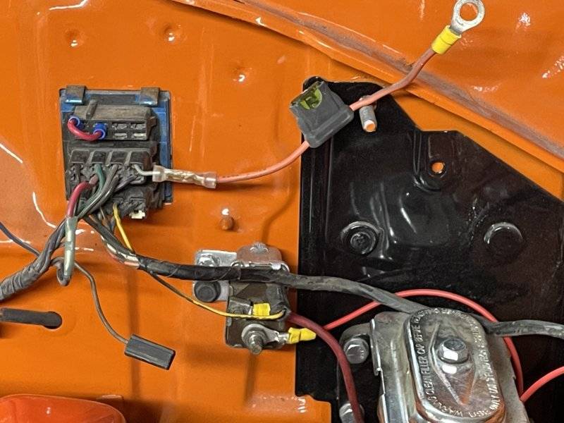

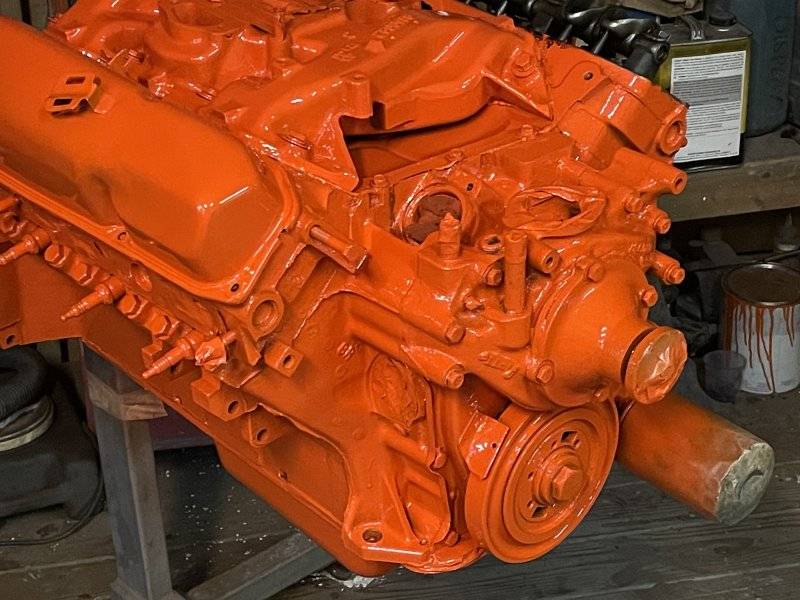

First off Merry Christmas to everyone,enjoy your time with your family,working on 69 Roadrunner ,it has a used 440 steel crank motor it’s a 69 did the first start up tonight,weather bad in Ct tonight,deep freeze any way engine sounds good but dosnt seem to want to take the gas ,it will idle ,it has a used 650 on it ,hood need it moves I swapped in a 4 spd ,what’s my best tuning route timing ck ?Richen up the carb I have a vedio of it running thanks probally won’t work on until MondaySorry couldn’t get it to post

Don't know how your distributor is set up? Just a note, your starter relay is mounted backwards!
