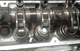

I too prefer ductile iron rockers.... Seen to many roller rockers fail... Tiny needle bearings floating around are not your friend...

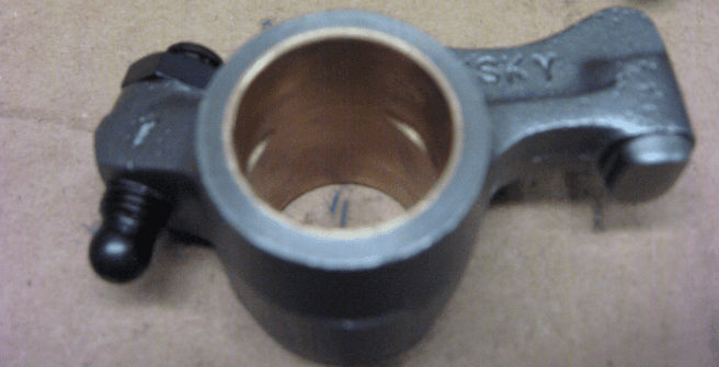

My Ductiles are actually Iskys, I have three sets... They have a hardened pad at the valve tip...

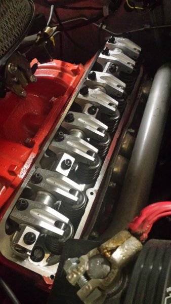

@1 Wild R/T , was that your engine in post #7? If so, what did you think of the beehives? I'm contemplating a set of conical for a solid cam rat motor, and user feedback is always welcome.

Sorry not my motor.. Never been a fan of roller rockers, just did a search & it popped up... Along with lots of other pictures.... But that one was clearly a Mopar...
I do have two engines with Beehive springs... I've had great results but some folks have had issues... But my stuff doesn't see over 6500 rpm's anymore..
What sold me was video's of valve spring testing on the spintron... Even triple springs start getting weird harmonics at high rpm's the Beehine because the coils are all different sizes doesn't have a resonant frequency...

Isky quit selling their really good rockers 30+ years ago... They sold re-boxed Cranes for another 10 years but honestly the original Isky's are the best aftermarket Ductile rockers ever made...
They use to be easy to find a swap meets, I never paid more than $100 for a set... Now when they turn up people are wanting $500 or more...

The picture in post #7 is PRW's.. The early one's were junk.. I've heard the newer ones are pretty good...

I agree 100%... But thats why I like the old Isky ductile iron rockers... No much can break & if it does there's no tiny needle bearings to cause bigger problems...
If I hadn't gathered Isky's back in the day I'd probably be running newer PRW's...
