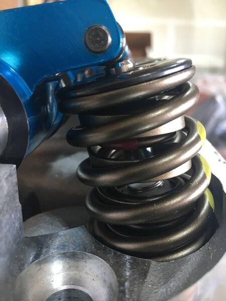

Hello,
I have a set of 440 source stealth heads and I was hoping to run the set of Proform 66868 rocker arms but they appear to be a bit short on the valve stem.
Any suggestions? I would like to stay 1.5 ratio, roller tip, and I don’t want to break the bank?
Thank you
Im running Comp Cams Pro Magnums. One of the things cheap isn't always better or just as good
Are you running them on 440 source stealth heads?
Watch your pushrod clearance on the Stealths. 3/8" wont fit without modification and 5/16 are a crap shoot, check them!!
Is this set back too far on the valve tip?
Harland sharps on CNBC stealth heads work great. But may break the bank. They aren’t cheap! I had to pilfer a little (lot) of cash from the wife’s account!
