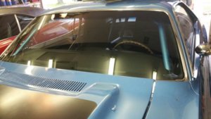

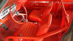

this is a very nice cage- a good point is that the dash was removed so the bars could be put where that are- the dash can be modified to fit over it. good job. I've seen many build a cage with the forward tubes and cross bar was on the driver side of the dash- now the dash can never be removed. yours is a clean effective cage.
That is the best way to install it. My A Pillar bars go thru the top of my dash also. Major pain on an E Body with the angle of the windshield & the purists cringe since the dash pads cost so much....

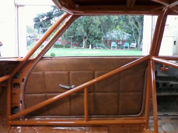

No issues with my door bars at any tracks. No, they are not 100% by the letter of the rulebook.
As I recall it added 80 lbs.
I don't think anyone will say anything. That being said a straight bar is much stronger. Are you worried about safety or just being able to race? That's up to you. Mine has WAY more bars than are required. The only time in View attachment 566761 5 years my car has even been checked for chassis cert or for a license is NMCA.
I want it to be safe, but I really didnt want to lose the armrests. No question the car is safer now than it was before. Glad to hear a few of you agree with my feeling that I won’t be turned away. I may add an identical bar on the passenger side at some point, but it won’t happen initially.
That's some very nice work going on there LW! Rear bars built and fit perfect and that door bar blends right in, not an inconvenience at all.
I bet there's been a lot of do I , don't I, on the right side door bar. If you were taking votes on it I be saying do it. It's not restrictive at all, looks terrific and would sure sturdy up that right side of the car.

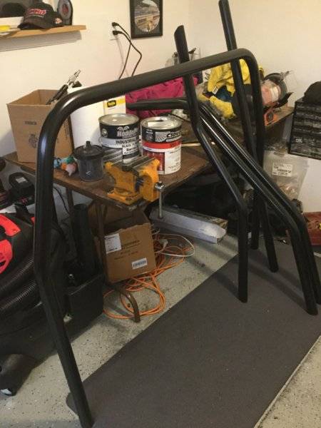

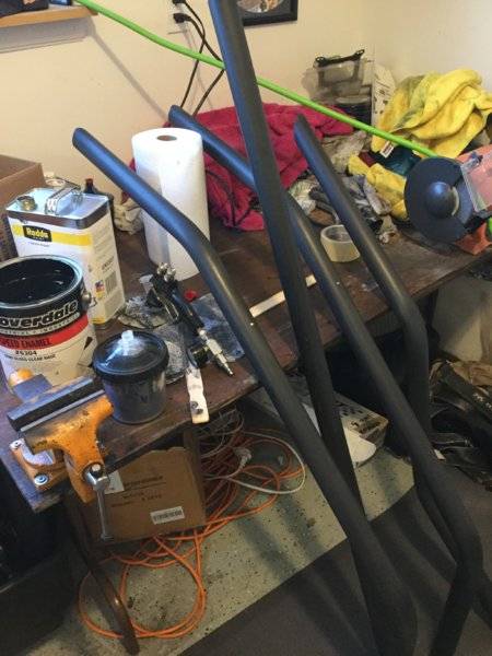

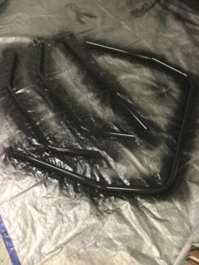

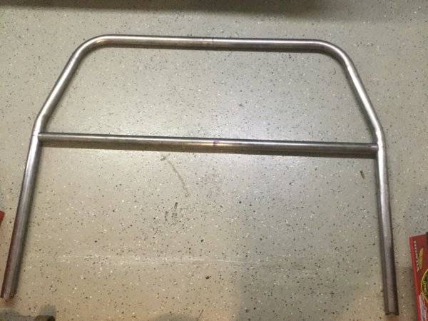

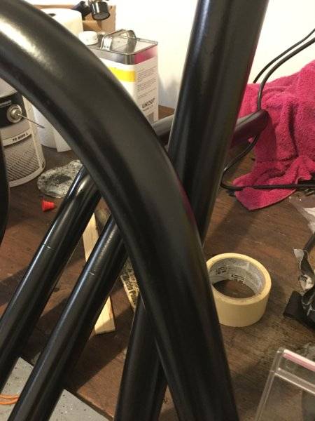

Got out in the garage today for the first time in a while. I got the bars back out of the car and painted today. I’m a sales rep for a paint company and got to use some of my own products to finish the bars. I figured I’d paint the individual pcs., then wire brush the ends back clean to weld, so all I’ll have to do once installed in the car is hit the joints again.
This should be a solid system for this application. I applied 2 coats of Rodda Barrier III rust inhibitive primer. Then topcoated with Cloverdale Speed Enamel, a phenolic modified semigloss topcoat. Sanding between each coat. Both are simple single component products, but should hold up well.

Final coat will continue to shrink down. I think I’ll be happy with the semigloss finish. I weighed all the individual components..... was very happy to come up with a total of 55 lbs. Raceweight should be right around 3865. Porky by racecar standards, but this is a full interior streetcar carrying all of its factory accessories, street wheels, and front tires.

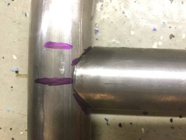

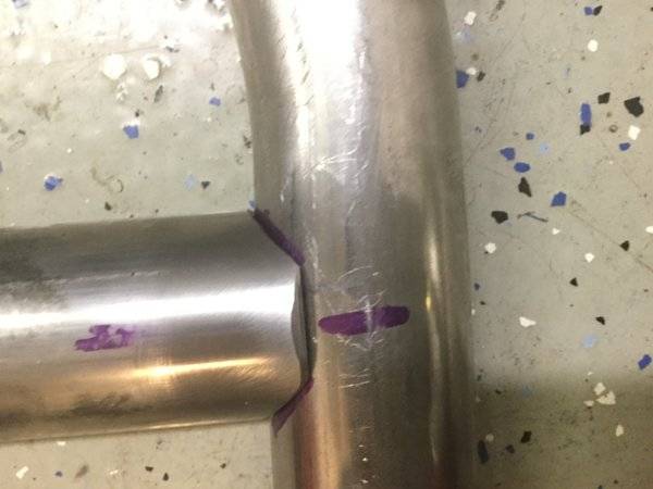

Well, after a few hours of practicing and finally using up all of my spare tube with practice welds, I’m just not satisfied with the welds I’m producing and I’ve come to the conclusion that my desire to have this project done correctly will outweigh my desire to do it myself. So I called a friend and fellow racer that does chassis work, and I know is a professional level welder. He is willing to help out by spending next Saturday at my place welding up the bars in the LemonWedge Plymouth. I spent today getting the back seat back in and the floor plates and bars tacked in place where possible.
