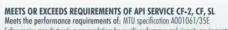

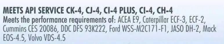

I thought the CI-4 was the better stuff? Been using Rotella for 20 years now but the newer stuff does not have the higher levels of ZDDP in it.....but right now, I'm not running anything without roller cams.
I believe CI-4 is an older spec and better, however I don't believe any of the Rotella is CI-4 anymore. It's labeled for CK-4, CF-2, or something other. Its best to look at the back of the container before you buy, but I think the T4, T5, T6 oil is CK-4 and should be labeled like below.
If it's T1, T5 ultra or one of the gas engine oils it's going to meet a different spec like the one below.
