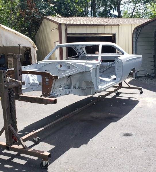

The only issue I found is door fit up/ If your fitting a door shell you want to compensate the weight for all the window hardware.
Also you will want to mount it so the fenders can be attached. I have done an early B body (65) and working on a 69 RR now.
Let me know if you need any mounting pictures. NOTE My Cars did not need any panel replacement's

Hello yes the car is fully assembled sheet metal wide no suspension I’m planning on putting it on there as It sit doors fenders attached to do the body work. Pictures will be greatly appreciated thank you

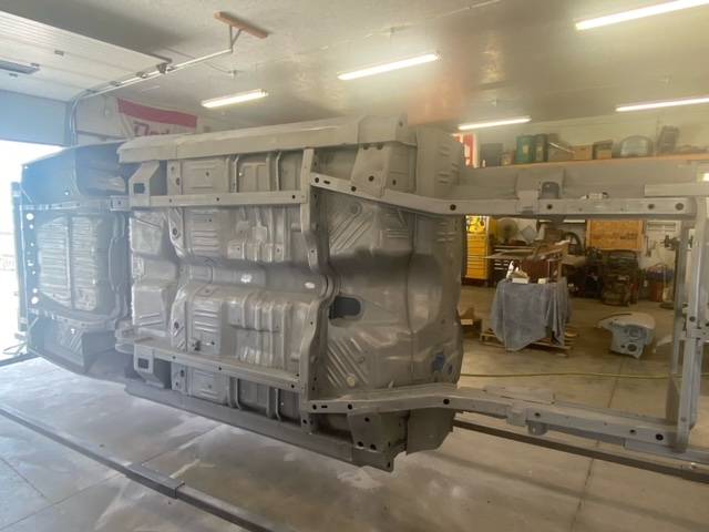

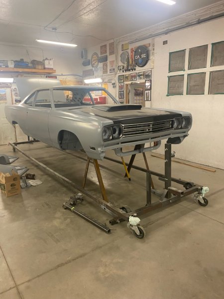

I built rotisseries for the past 17 years - over 300 of them for all makes an models. I didn't mount all those vehicles personally but had enough feed back from customers to know. If you support a body at both ends, its gonna move in the middle - guaranteed. Any customer who told me they planned to do sheet metal replacement on a rotisserie was TOLD - not warned - TOLD not to do it. When my own car was done last year the panels were fitted with the car sitting on sawhorses where the rear end and front K would mount. This is as good as you can hope for with a bare shell. The car was then put on the rotisserie for paint. Final fit after paint was done back on the sawhorses. And now that its back on wheels with the drivetrain in it will need some minor tweeking. FWIW, the car doesn't twist, it bends in the middle. And is most noticeable at the door gap.
When a car is on a rotisserie the arms have to be long enough that you can assemble the car on it with the hood and trunk lid in place. Both of these need clearance to open so you need a foot of clearance at each end to the rotisserie. The rotisserie mounts using the bumper bracket holes front and rear. That's a lot of weight hanging in the middle.
In the second photo - note the frame connectors and torque boxes front and rear. Firewall supports were also added when the car was on the sawhorses.
