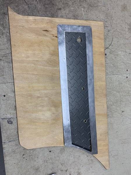

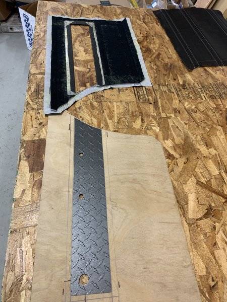

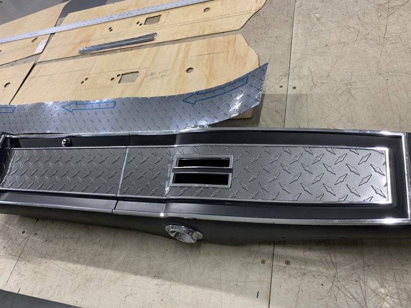

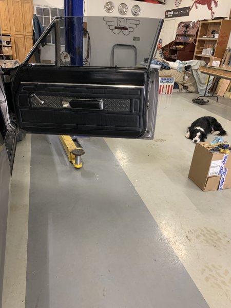

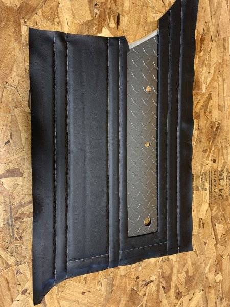

Back to working on interior. I used this diamond plate material on the console, and will be adding some to the door panels.

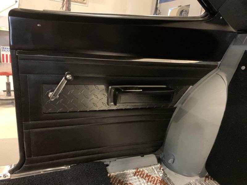

One door panel done, I like the diamond plate inlay, looks like a 60’s car.030616F9-86C5-4450-8DEB-06057B04BC8E.jpeg

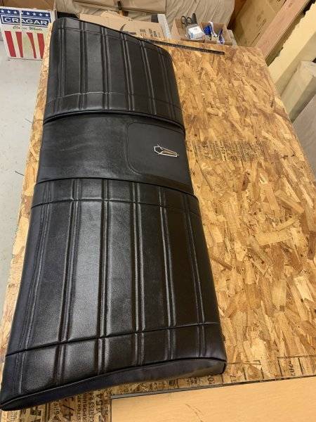

Have been improving the methods for making the inserts look right which is a good thing, except for now I have to do the first one over.

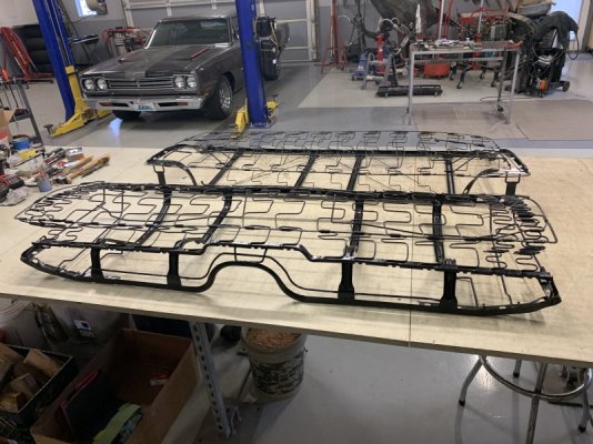

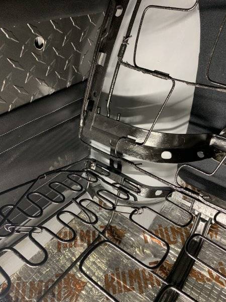

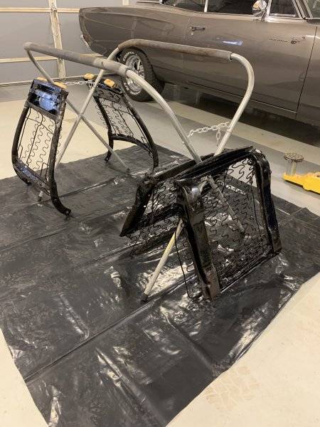

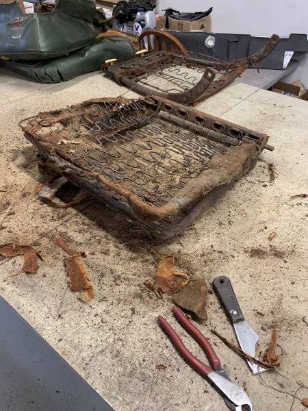

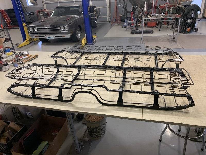

Cleaned up the frames with wire brush and muratic acid solution, then coated with Ospho and a good enamel with hardener added. There is a latch on the bottom corners of the upper frame that does not look like it attaches to anything. I must be missing something.

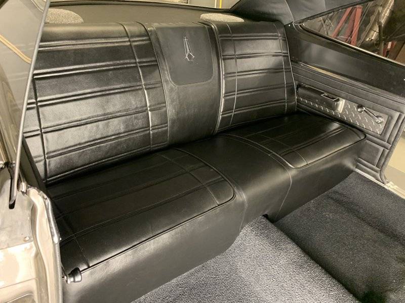

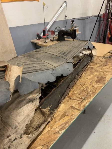

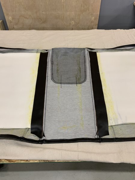

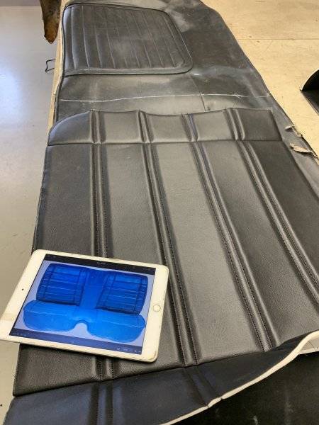

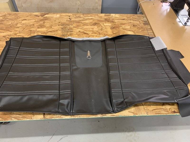

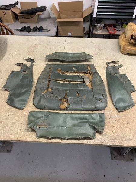

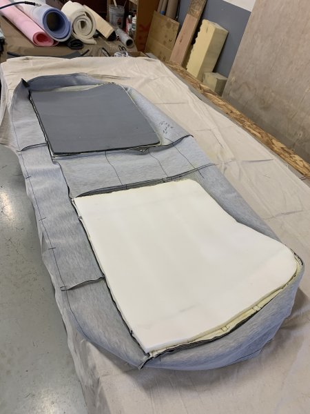

The back seat is not the right pattern, so I am making the inserts according to a picture from the net.

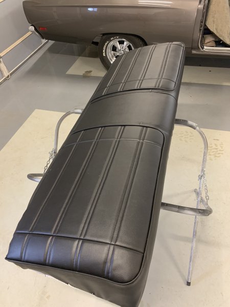

Back seat coming together, a lot of work for something that probably will never be sat on.

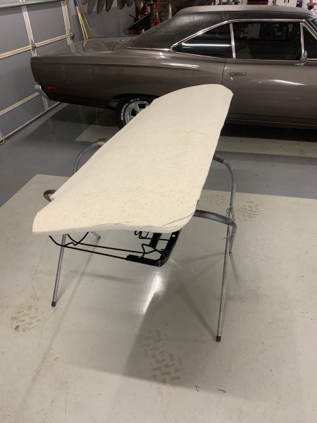

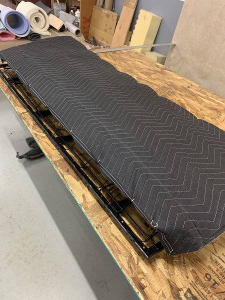

I used three layers of Harbor Freight moving blankets sewed together on top of the springs, and put 1/2” foam on the back of the seat inserts. After the emblem went on, put 1/4” foam on the center section. This is the backrest.
I think I set the emblem too high but it is too late to move it, so went ahead and stretched it over the frame.
Only about 50 years too late to nail a high school chick back here, unless of course she went to high school with me.

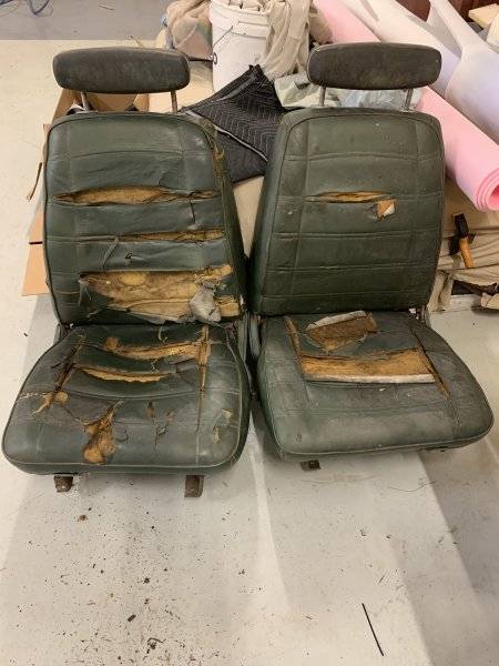

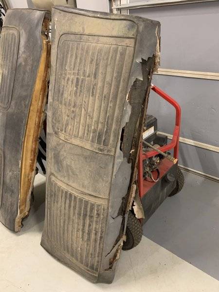

Well these two rascals are next. I drove the car 800 miles on these with blankets wrapped around them.

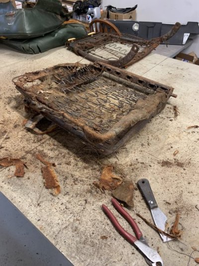

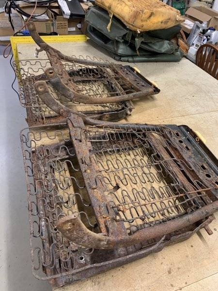

EC0FEFAA-3ADB-4789-9A38-8E714A36D6BE.jpegSo this is it, the last of the rusty parts that need to be cleaned up and painted on this project. The molasses tank will take too long so tomorrow I will rig up something to dunk these in evaporust.

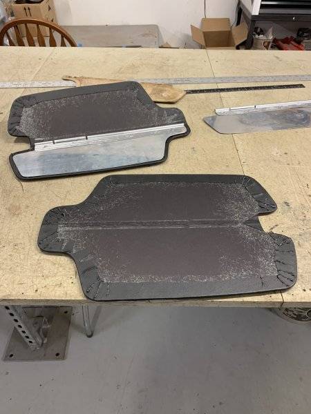

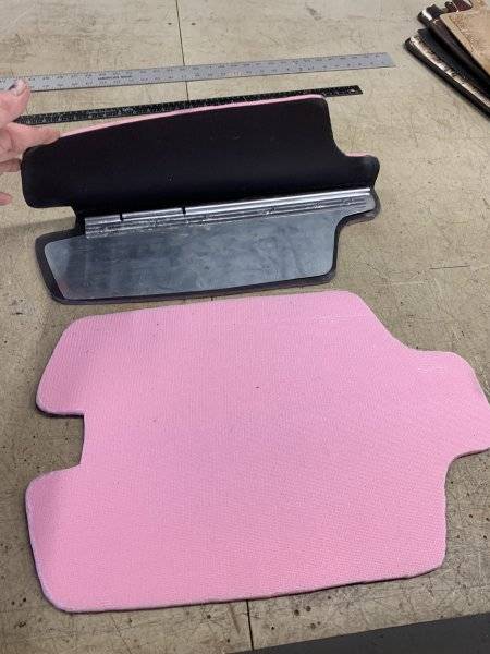

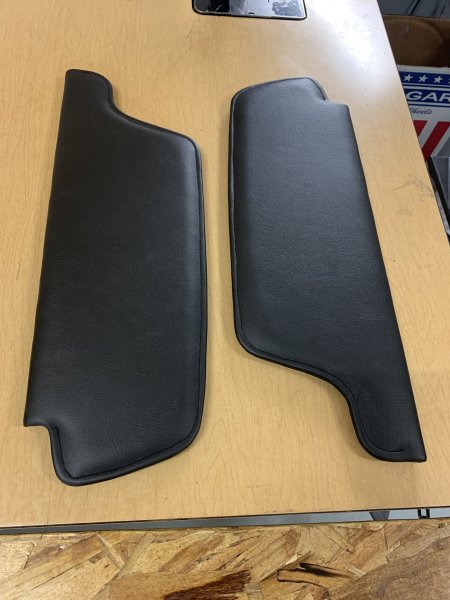

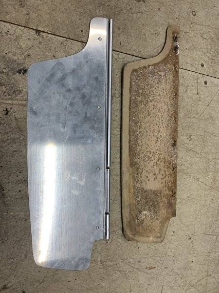

Made new visors while I am working on seat frames, replaced the moldy chip board with aluminum. The black material is 1.5mm thick poster board from Hobby Lobby. The pink is 1/4 scrim foam.
