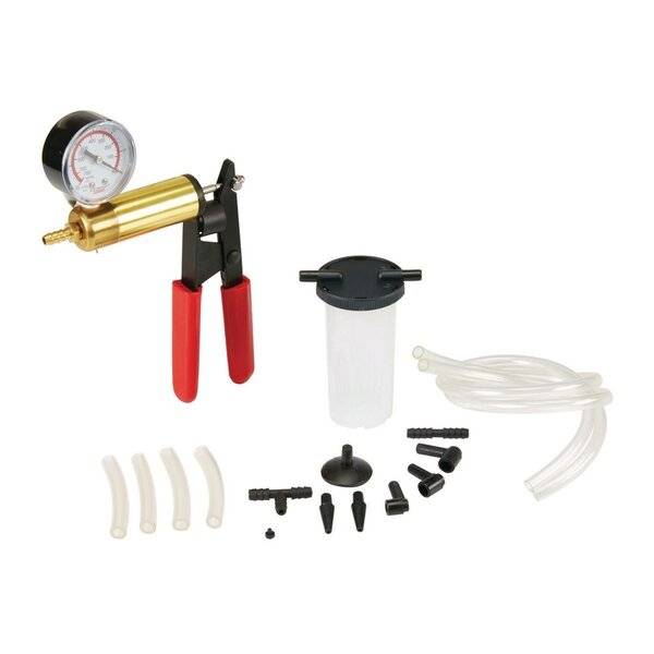

get or barrow one of these pumps, grab some distributor springs and a 3/32 Allen wrench for the can nipple. With the distributor cap and rotor off you can watch the weights and the vacuum.
I think your going to need a little more spring than you have now. If I recall the can adjuster will let you you pull in or out vacuum point a couple degrees each rotation of the adjuster.
I do not remember what direction to turn to go up/ down , just have to mess with it.
