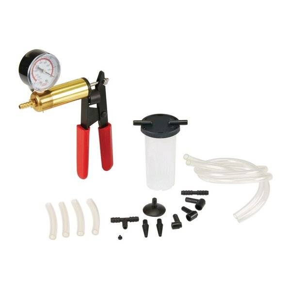

View attachment 1055706get or barrow one of these pumps, grab some distributor springs and a 3/32 Allen wrench for the can nipple. With the distributor cap and rotor off you can watch the weights and the vacuum.

If you get one of the digital dial back timing lights that shows RPM, it is pretty easy to check haw much advance you are getting at different RPMs, and the RPM when mechanical advance stops (with vacuum disconnected.) Add the vacuum pump noted above and you can see how much vacuum will advance the timing.
