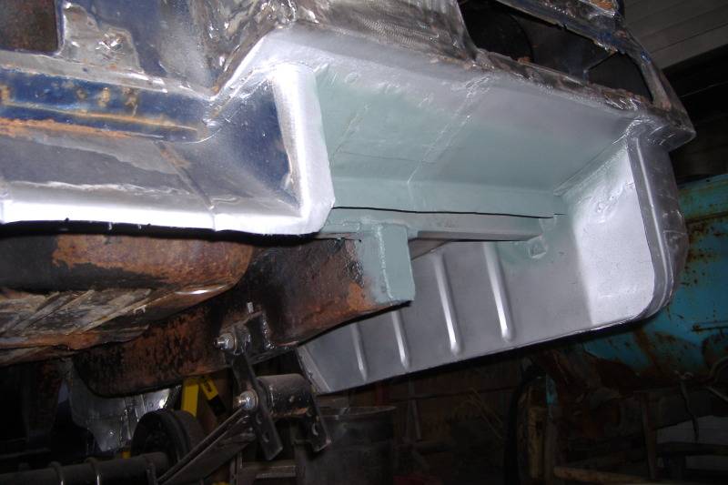

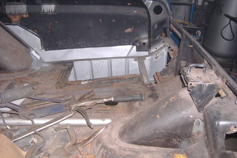

The gravel pan was removed and proved to be repaired in several layers over the years. nothing worth saving so a new one would be fabbed.

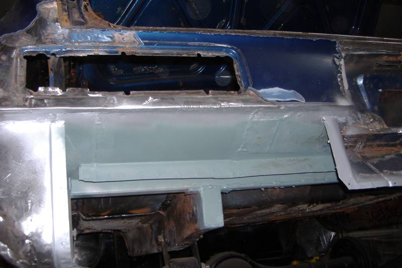

The rear crossmember was bad so I cut it out and replaced it with a piece of 1 1/2", thickwall square tube. It sounds small but is actually much stronger than what was there new.
Sections of the floor had to be replaced and the original shackle mounts were removed as the shackles are thru the main rails now.
The front section of the trunk floor was full of pinholes so I cut the whole thing out and fabbed up a new floor section.
It isn't exact to the original but thats fine.
The inner wheelwells were soft so I made new pieces to reattach them to the floor.

Made some tabs and welded into the boxes to spread the load along the tube instead of across the weld.
The boxes weld directly to the connectors because the lower sections of factory rail were a bit rough and I couldn't really trust them.
Put some strips along the top of the boxes so I could bench weld the attachment and also give myself a bit of adjustability while they were being aligned to the rails.
I used some threaded rod and a full length piece of steel dowel to act as a guide to align the boxes to the car.
No original spring mounts left to work from!
