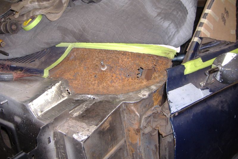

the upper cowl area drivers side was a sore point for several reasons. Didnt realize just how big a sore point until I started to dig into the area.
Apparently Chrysler saw no need for water drainage in this chamber.
They were wrong.

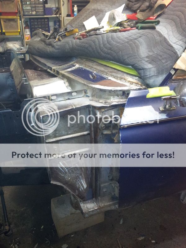

I repaired the upper firewall...
...and then cut the flange area away from the cowl top.
The amount of rust is obvious.

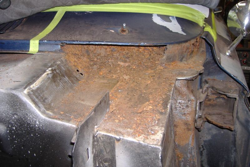

Once the initial shock wore off (2 seconds...I'm used to it now! LoL) I went ahead and reconstructed a new flange all around. I did that now because it assured me of getting the height right. If I did it off the car it would have been more involved and less likely to work.
Then I cut the top off as planned...exposing the hidden rust!
I kinda got into the repair a bit too deep and forgot to take many pics of stuff getting made and welded but you can see from the completed pics that I made the pieces in sections so they could go in without stressing the wiper pivot mount. i basicly made the new over the old and the cut the last remaining connections to the rusted bits out from inside the car.
Worked out good and the pivot and pivot hole in the cowl top remained aligned.

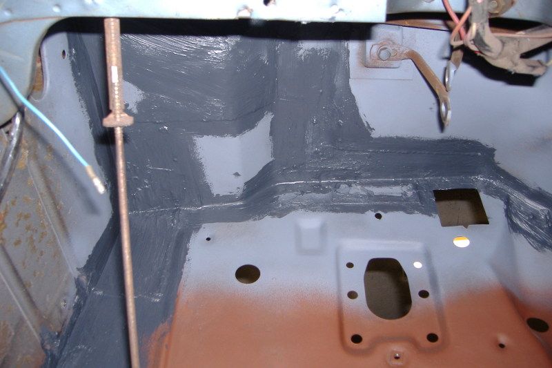

due to having to get a good layer of seam sealer right under the windshield pinchweld area I actually had to weld on the outer section again and recut it off lower!
By doing it that way I was able to seam seal without having the final weld burning it up.
This pic shows it welded and recut...sealed and painted inside.
Then it was final welded into place...
...with a nice big drain hole that Chrysler forgot to include!

Once the top was back on that side i went ahead and finished off sealing the rest of the chamber, painted it inside and then repaired the top piece over the brake master cylinder area.
Then...finally, I was able to put the top back in place and consider the cowl done! (other than the grinding and bodywork of course!)
The inside was also sanded, primed and seam sealed as well.

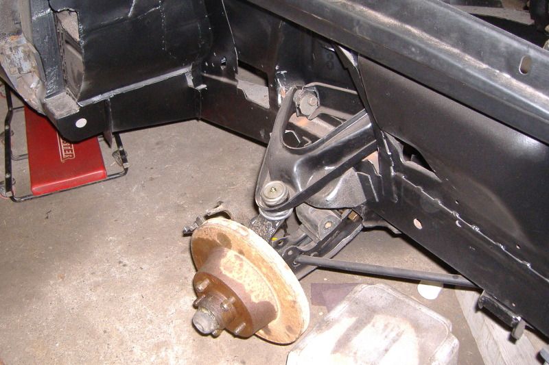

Around this time i was also fitting the front and rear suspensions back together and getting the bits painted up etc.
Not really getting crazy with detail...just cleaning up any rust, priming and then hitting with satin black.
It's clean and looks fine to me!
Ignore the rusty rotors...they're just rollers.
Because I adapted springs I had a bit of an issue with getting the tires to fall exactly where I wanted them, so I ended up redrilling the pads to move the rearend slightly forward. Seems to be alright now...but I left the U bolts only tight rather than fully torque them just in case. If I still need to move the axle a bit in final assembly at least I won't have to buy more!
Had to get her rolling...'cause the frisky ol' gal has a date across town!
