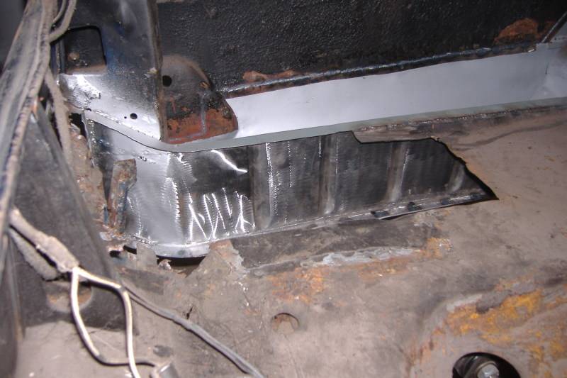

Brought the old girl to my friend Fitzees shop..."Island Rod & Kustom Ltd"...where we both did some work on her in an effort to get her ready for the road this summer.
I started on the passenger side wheel arch while Fitz made the left lower inner and outer quarterpanel from scratch.
The wheel arch involved adapting a front fender arch from a 67 Belvedere, but like the other side it needed to first be made to approximate the original 63 Dodge shape.
Seeing as how I already did the other side, I also did this side.
Fitz would do both lower quarter sections.
That way...neither of us had to guess at how the other guy did something.
Theres some gaps in the pictures of different steps of the installation...but we were trying to get a lot done each night and simply forgot at times to snap a few pics when we should have!
You can still get an idea of what was going on though.
BTW...should clarify...this wasn't done in just one night!!!

As I said at the beginning of the last post...while I did the wheelwell arch, fitzee was busy making new inner and outer lower quarter sections for the drivers side.
He did a bang up job I think!
I'll let the pics tell the story...
I know I'm biased...but damn I think he did a great job!

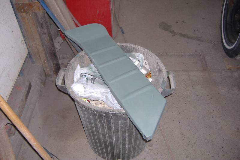

Fitzee used mostly basic tools...hammer and dolly of course, but also his homebuilt bender and an old "T" anvil with a nice long, round profile.
He does have a small homebuilt English wheel that he gave it a few passes thru to tighten up the roll...but honestly I think it was just a bit faster to use that.
He could have done without it.
The inner panel was beaded using a press former he made up for some different part on a different car...but it worked for this stuff too.
I think the hardest part was the bottom of the wheelwell itself due to the many turns and shapes required.
It took a lot of time to do...and ends up being the most ignored part!!!
