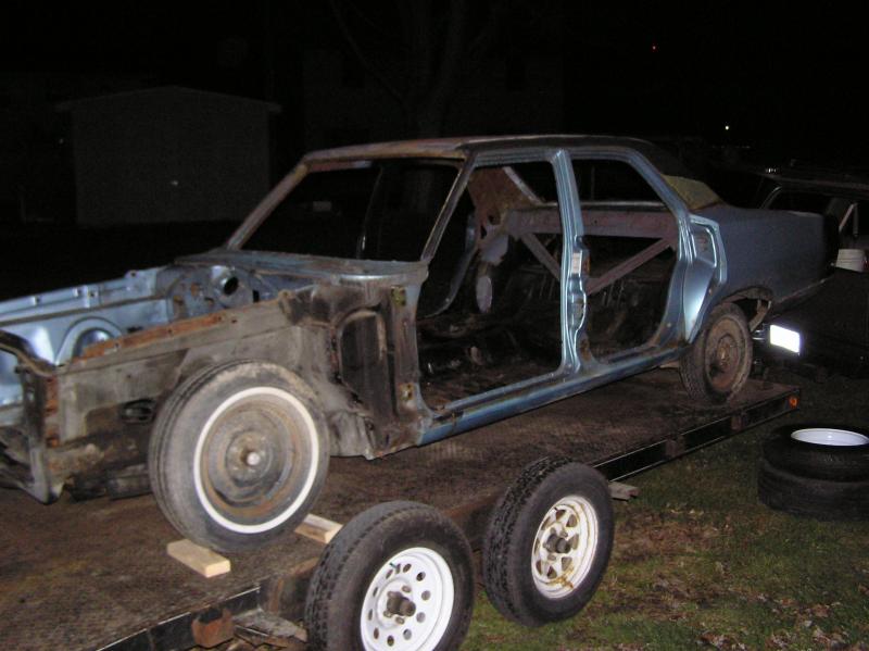

This is my first project thread, and thought I would share it with everyone.
What I have is a 69 Coronet 4 door parts car, that I bought with the idea of using some of the uni-body parts, for my 69 Charger restoration.
I know that my Charger needs rear frame rails, torsion bar cross-member,floor pans, trunk pan, rockers. Most of which will go into the Charger.
I know that the trunk pan is different between the Coronet and Charger, but I thought I would remove the pan with the Rear frame rails and put them into the Charger as one unit. (this way everything stays in alignment) Later I would remove the Coronet trunk pan and replace it with a Charger pan.
Anyway, I know what I want, just not sure how to get there.

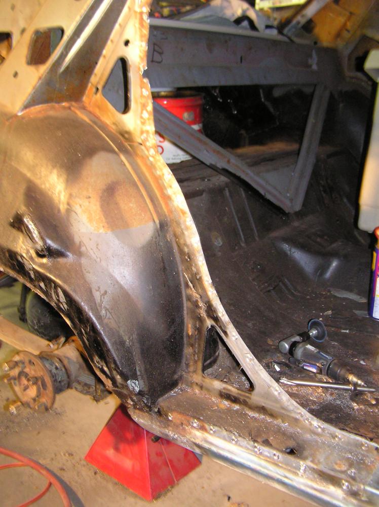

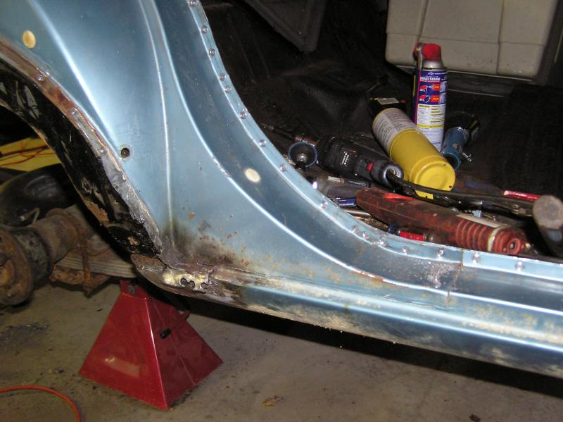

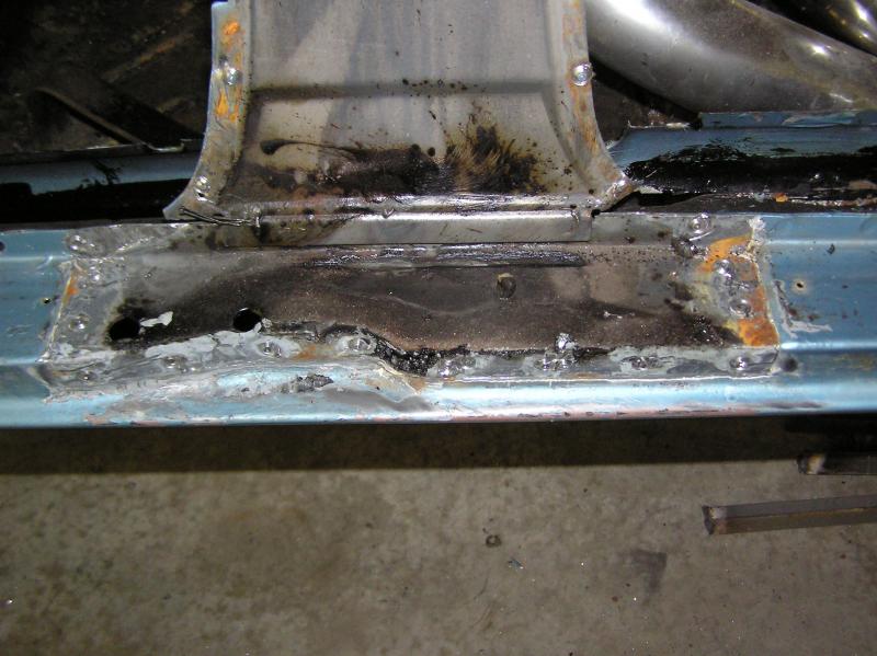

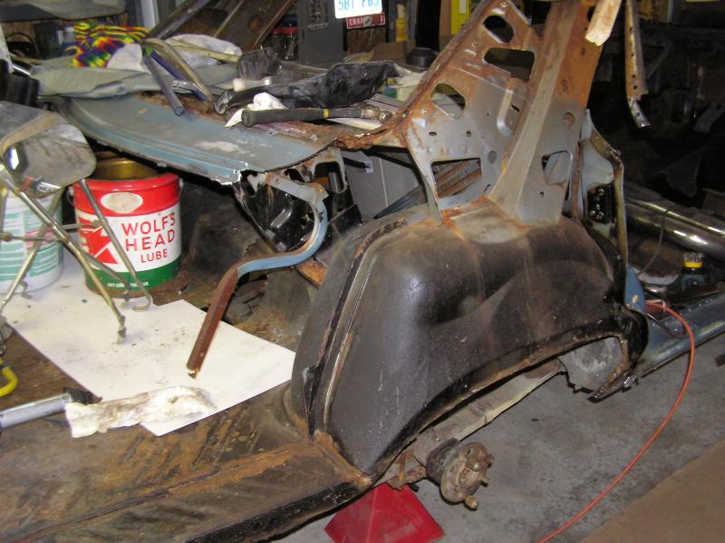

The 1st thing I did was to remove both quarter panels. Sorry no pics of this, but it was a pain in the rear. (lots of spot welds) Thanks propwash for recommending Blair spot weld cutters. It works GREAT!
Here is a pic after the quarters were removed.

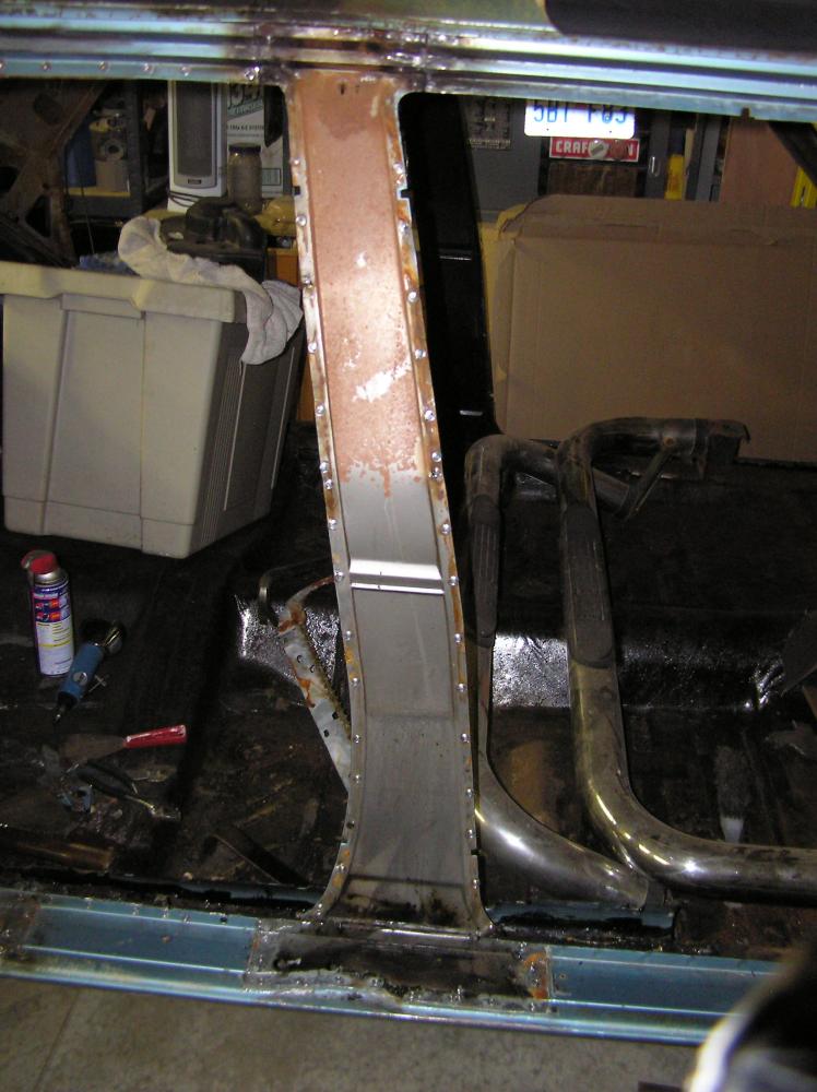

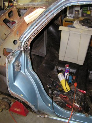

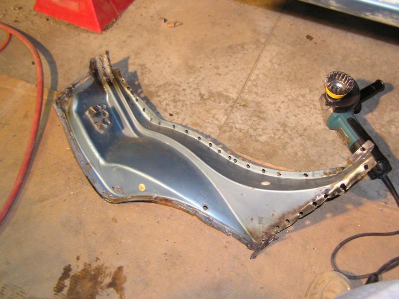

Next I started on the C pillar or rear door jams. Man figuring out how these parts come apart and the best way to get them apart is NOT easy! Oh well, now I know how.
Used a torch to heat up and melt out the lead in the lower corner. Then drill out and separate all of the spot-welds.
SUCCESS!!:banana::banana::banana::banana:

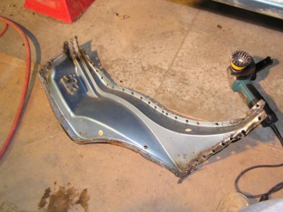

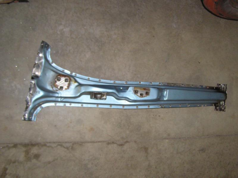

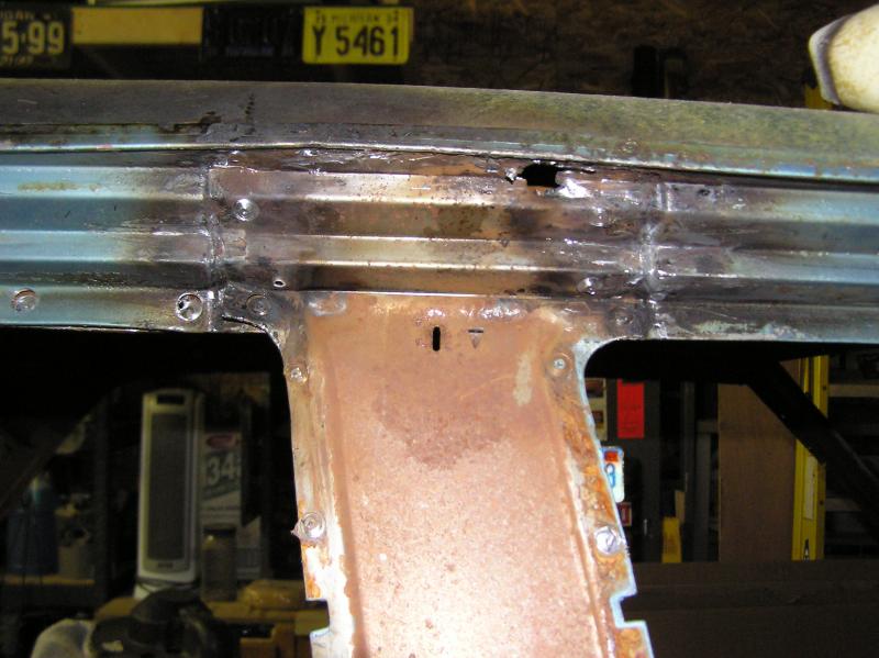

Next I tackled the B pillar.
After I got it removed. I realized I didn't need to drill out all the spot welds running up and down on both sides. There is no need to leave the "backer" like I did. It would have come off with the b pillar if i would have removed the spot welds on the top and bottom. :banghead:
Oh well, live and learn.

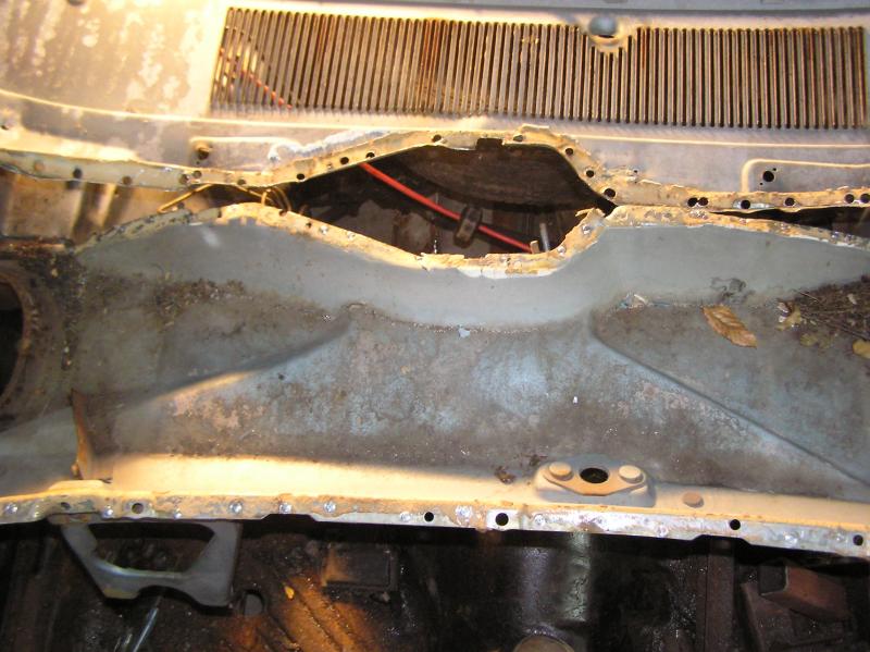

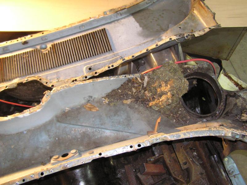

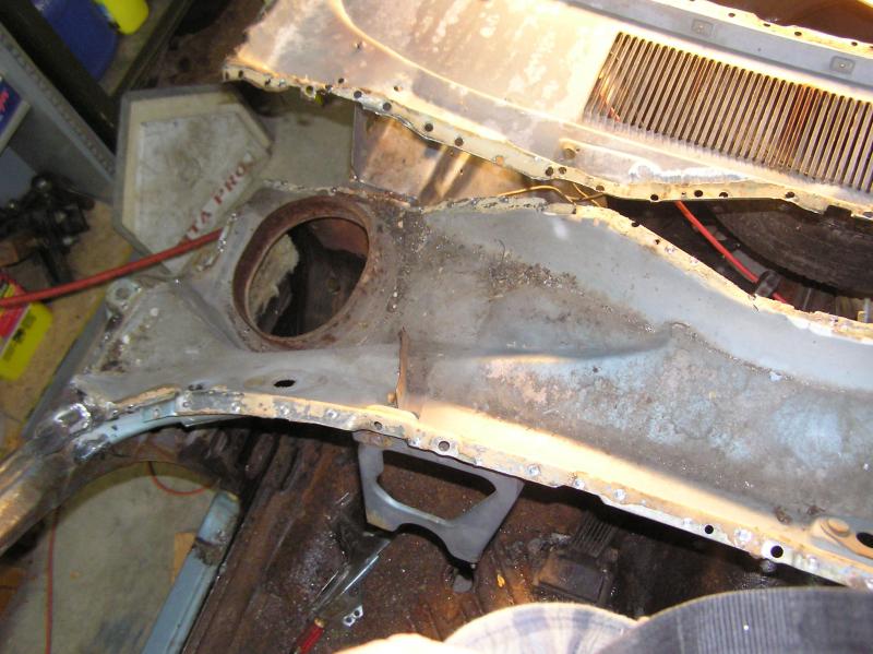

Then it was on to the cowl.....
Found a critter nest.
Overall the cowl area looked good.

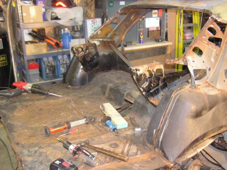

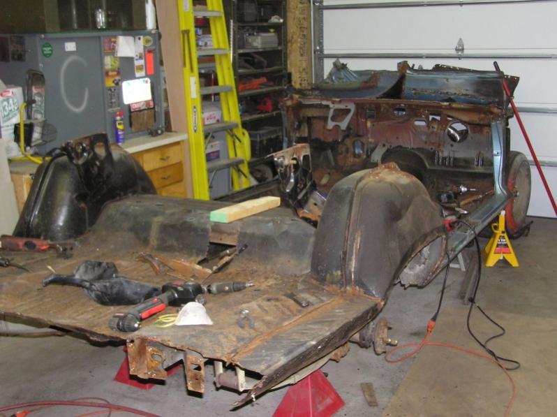

I then removed the rear package tray and roof
