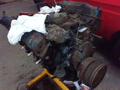

Hello all. Been a long time since I've posted anything. Got a new job in April, my daughter was born in February, and have barely touched my car. I did get this though.
It's a 77 440 out of a town and country. Couldn't pass it up. So now I just need to figure out what I want to do for a transmission. On top of everything else. I did install a door skin on one of my door shells. I'll take some pictures if I get a chance. Went ok, now I'm nervous about doing the other. Hopefully I'll get more time to get more done.

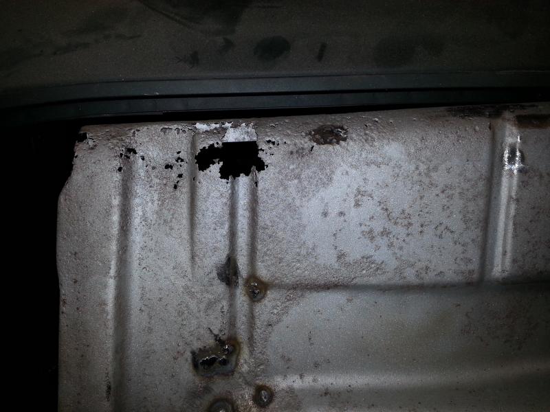

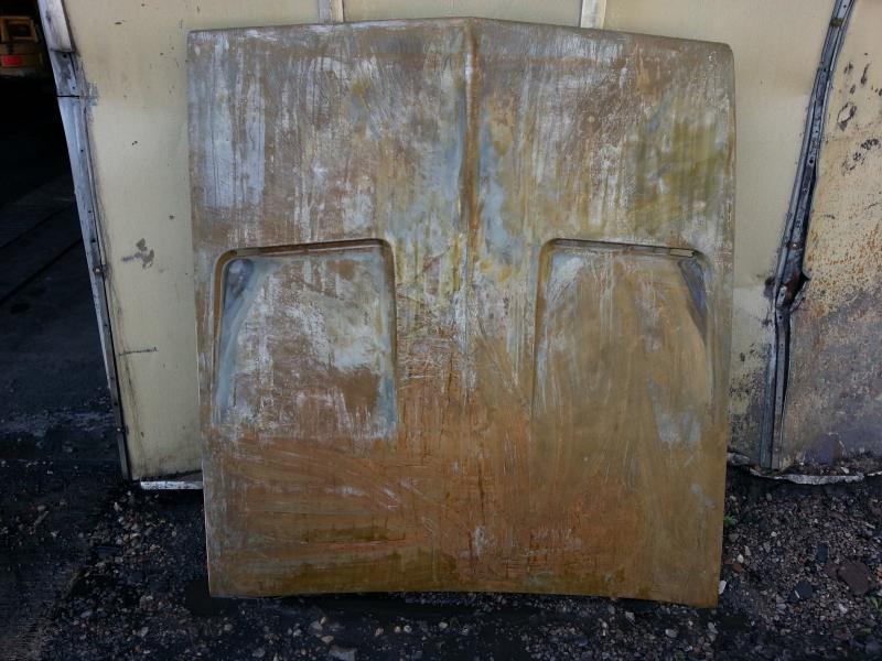

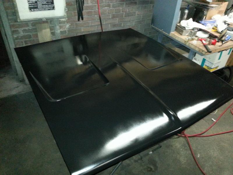

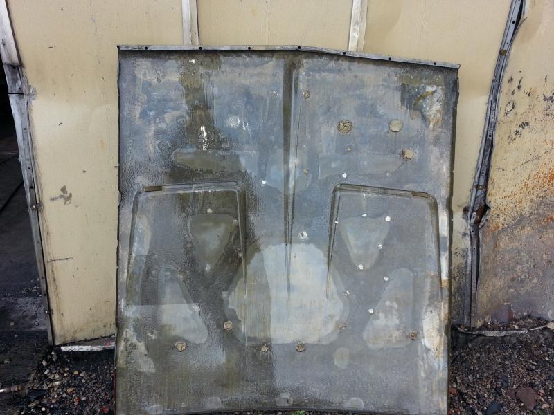

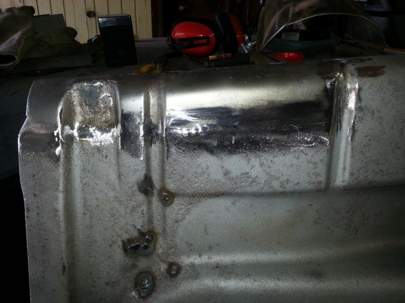

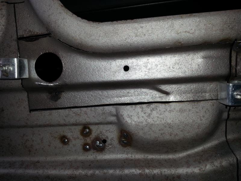

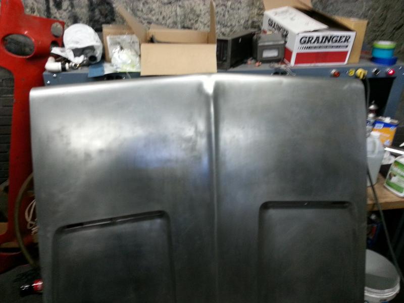

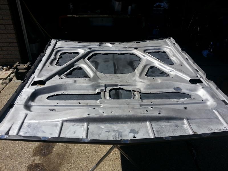

Ok drum roll....View attachment 220575 came out rather well. It did flash rust after the power wash.View attachment 220576 Most of it came off with scotch brute but I did give it a very light sandblasting with low pressure. View attachment 220580 After all that it got two coats of epoxy primer from the good folks at ppg. View attachment 220584 I did have a few little pin holes in the front of the hood that I welded up and ground flat and covered the back of the hood skin with rust bullet. Next came the frame a different story all together. Many hours of welding holes and putting in patches.View attachment 220585View attachment 220588View attachment 220589
So after many hours and most of the summer I have a hood againView attachment 220594
