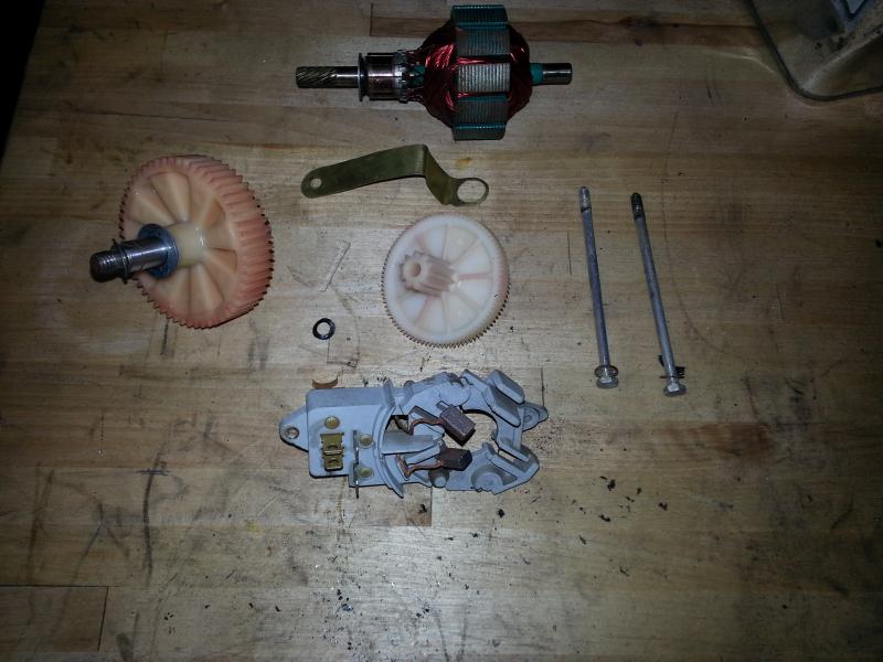

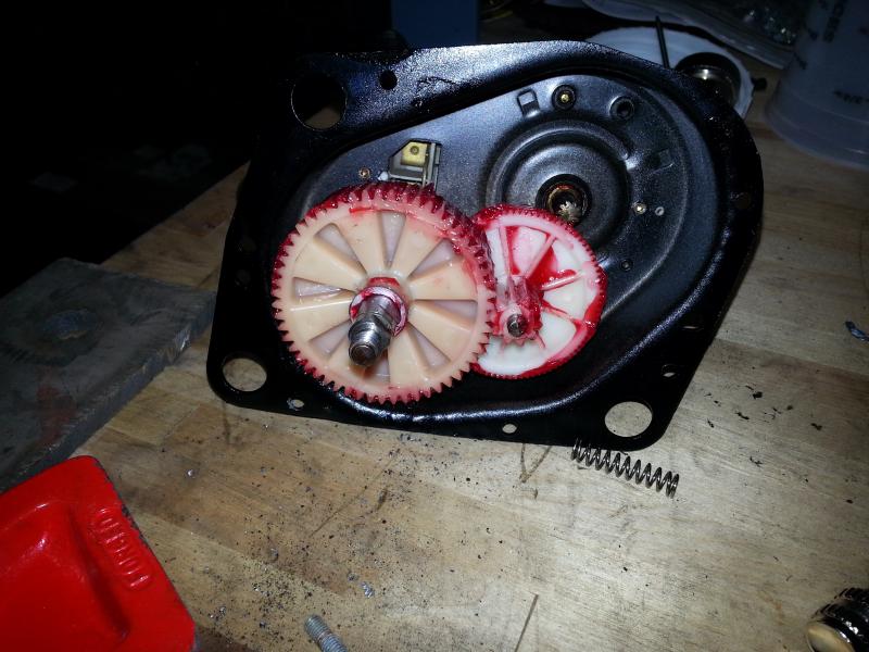

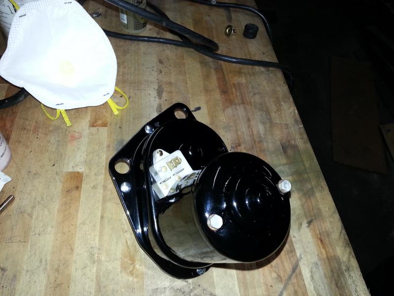

Took my windshield wiper motor apart yesterday, cleaned, blasted, and primed the housing. Probably going to paint it tomorrow. I don't know why but I was surprised to see plastic gears inside. All in all motor is in good shape, and brushes are good. I had a hell of a time finding rivets to put it back together thank goodness for old mom and pop hardware stores. Also tracked down some new rubber mounting grommets. Should be pretty in a couple of days.20140328_143843.jpg 20140328_144731.jpg

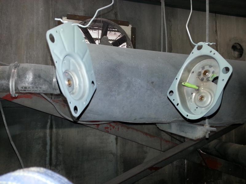

Well, all back together and shinier than it ever was. Still looking out for the mounting grommets, the ones I found don't have the right size sleave. Anyway all greased and ready to go. One down countless other parts to go.20140401_092910.jpg 20140401_104856.jpg
Does look great! Your going to have some nice parts going back into this looking like that, sometimes its the little things some forget, but its all part of the process and no worries in the future of things working right when done up right! More parts then we realize sometimes that need the same attention as the major build..
Wiper motor looks great. Did you try Kim @ Passion For Mopars for your missing grommets?
Thanks hunt2elk. That's exactly what I need, grommets, sleaves, and the nuts. I think someone tightened my motor down with a 1/2" wrench at one time. Made the metal sleaves look like an accordion.

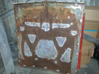

Got some more work done this weekend. Against all the recommendations I could find, i seperated my hood anyway. All of the supporting filler had seperated from the skin anyway so it came apart rather well. Lucky me, There's a prize inside. A nice sized mouse nest to help with oxidation. View attachment 184083View attachment 184084View attachment 184085
The skin looks to be in good shape on top. In the pictures all thats left of the layers of paint and primer and paint and primer... is some original red oxide primer.skin.jpg
Frame has some issues but I think can be saved. The skin I'm leary about blasting, might end up soaking it or dipping.
Anyone have a donor frame for replacement or for parts I can use for grafting?

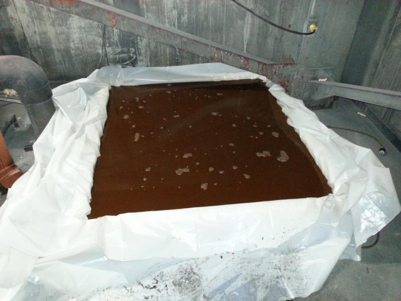

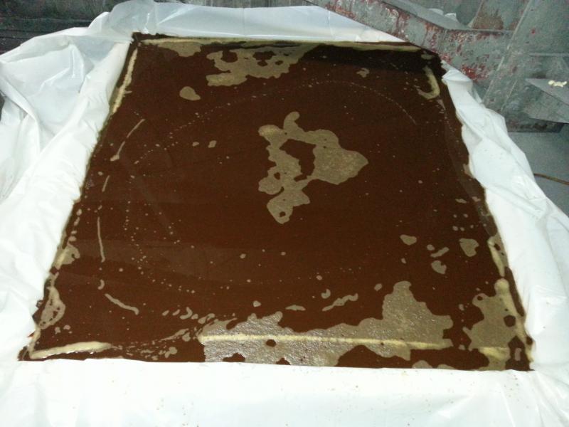

Well after much research and being scared as hell to sand blast my hood I decided to try molasses. With a little bit of cheap lumber and $25 worth of molasses I took the plunge.20140514_135711.jpg20140514_142721.jpg
about a 9:1 water ratio some mixing and in it went. I saw it working all over youtube so what the hell. Its still cheaper then eastwood rust dissolver. You can see the outline of the hood in the bubbles I'll pull it out in a week to see how it looks, fingers crossed....20140514_152018.jpg

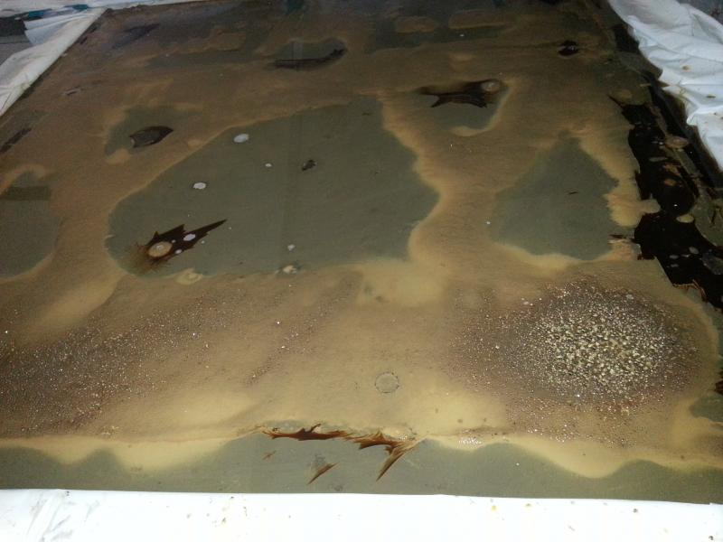

Well it's getting a little more exiciting. It's been in for a week and Everywhere there was rust there are bubbles floating on the surface. You can see the pattern in the pictures.
I have a little circulating pump in there now hopefully it will speed things up. I might lift it out for a peek on friday to see how it looks. Might do my deck lid next if this works.
I've never heard of the molasses method. Very cool. I'm looking forward to seeing the results.

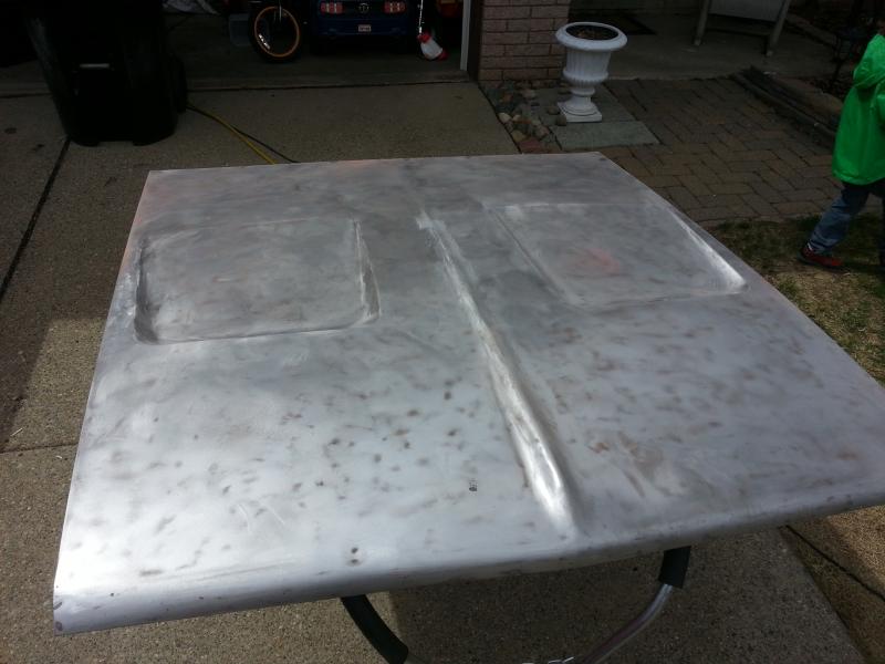

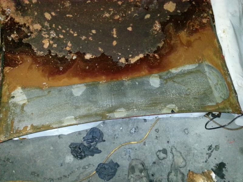

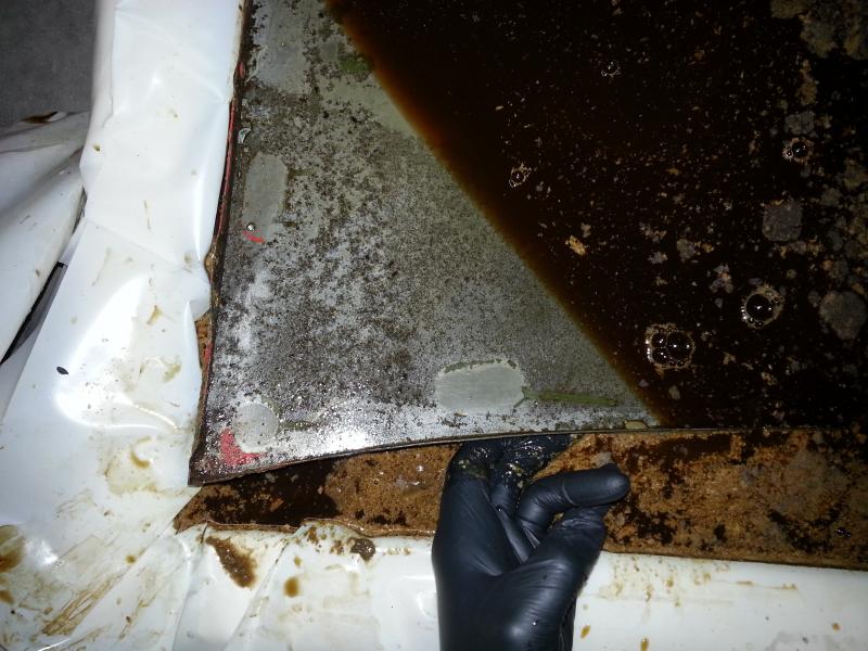

After 9 days I can see progress. I lifted the bottom corner out today and rubbed it with some scotch brite. More or less wiped it with the pad and this is what I saw.
seems to work rather well I'll give it another look see on Tuesday.

It's been two weeks officially and I have to say it looks pretty good. The waiting sucks but it's the least amount of work I've done on the car with still getting something done. I think I'll pull it out friday or early next week. I'll have to give it a coating of something quick I know it's gonna start rusting immediately. Still have some work to do on the frame before it goes back together. Thanks to SGT Paul for some hood parts and the idea of using seam sealer between the hood and the frame. Should work out good.
