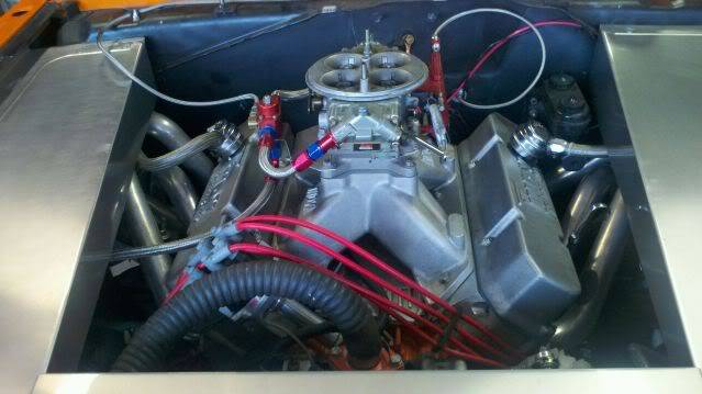

I picked up a 512 ci. engine and trans in Jan-Feb of this year with the Charger in mind.
Here's a few pics of the old combo.
440 auto.
Pic of the new engine going in.

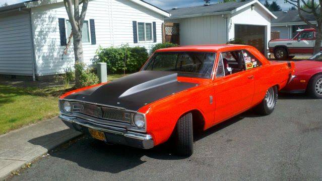

Here's a pic of my 67 Dart that I got into the 10's with a 440 and on pump gas.
This is at a Pinks race.

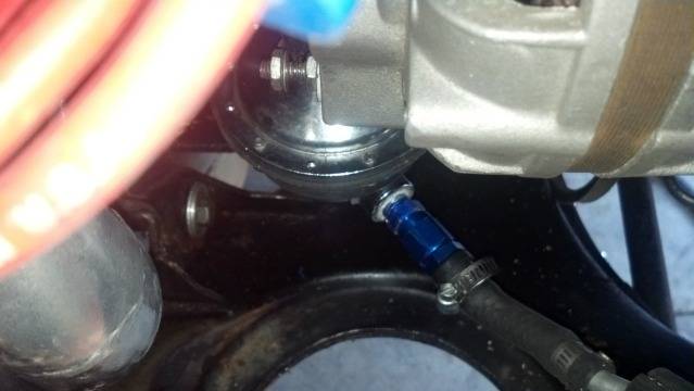

Well I decided to put a 3/8th's fuel line in.
It has a Holley 110 gph fuel pump in it so I put a 75 gph electric pump in to push the fuel up to the pump.

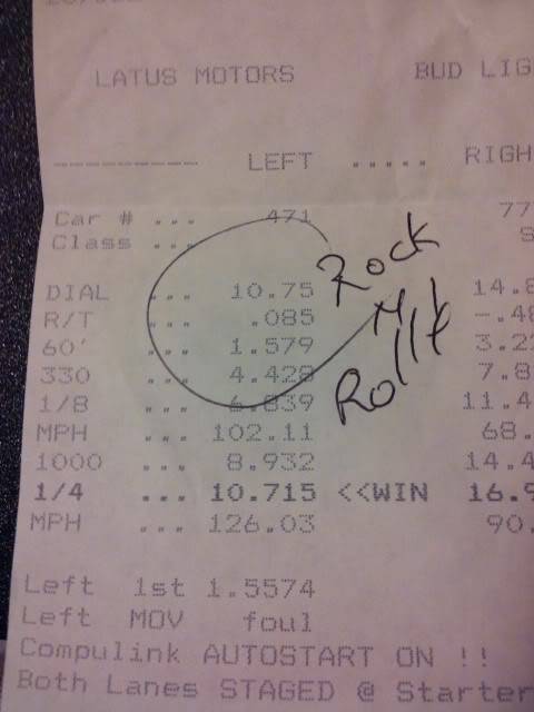

Went back out and made another pass and ran a 12.04 Trying for a good light went .001 red.
Cooled the car down air was better,wanted a 11 sec pass.
Took it out again and Launching soft out of the hole and 3 ft out flooring it and here's my 11 sec slip.
Need to work on how the car launch's.
The car in the left lane was a 72 duster with a 440.
He was kinda looking down his nose at my car.
It was a good feeling beating him.

If you do put an electric pump on the car, make sure to put an adjustable fuel regulator on it, preferably a By-Pass style with a return line back to the tank, keeps the fuel cooler & adequate supply at the carburetor flowing "at all times", have the fuel regulator & a fuel pressure gauge, before the carburetor, close to the carburetor so you get an accurate fuel pressure reading, set at 6.5-7psi max, set your Float bowl levels so they are "overflowing", add a piece of rubber hose with a hole cut in it in the center for your bowl vent tubes so it won't overflow, add more Accel. Pump Discharge Nozzles/"squirter" size go up 3-5 sizes, see if that helps some, maybe even add 50cc accel. pumps & mildest pump cams also, especially if it likes the larger squirters, also add some jet extensions, on the rear bowl jets, so it doesn't starve for fuel, under hard acceleration, add a K&N air filter & Xtreme top for superior flow.... I would also highly suggest buying the books "How to tune a Holley Carburetor, for Performance" & "How to tune/build a Big Block Mopar Wedge"

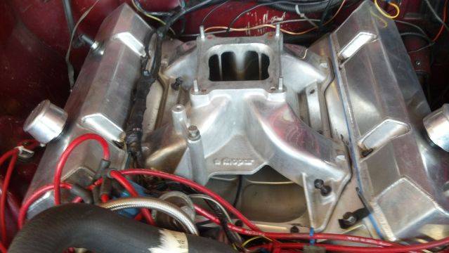

Decided to change to a single plane intake.
Took off the Performer RPM.
Put on a M-1 single plane intake.
I bought this engine in a car that I had purchased just to get this engine.
When they put the RPM on they left a 1/2 of a paper gasket on one runner.
I'm hoping this was where my stumble was coming from.

Budnicks,
This is my street car.
I was fighting the stumble and worked my way from what I thought was fuel starvation.
To a lean condition.
I always preach tearing down a new engine.
I new the shop that assembled the engine.So I didn't tear it down.
Stupid mistake on my part.
The gasket not being cleaned off correctly threw me for a loop until I took off the manifold.
I will be putting the jet extensions back on before going to the track.

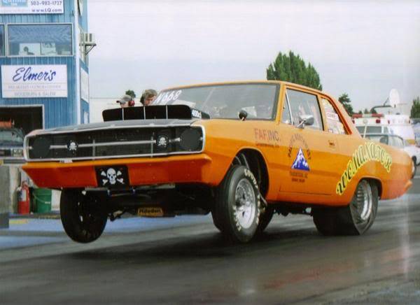

Here's a few pics of my race car.
Best time to date is a 9.02 @153 1.18 60 ft time.
400 based engine,727 trans-brake,Dana with 4.56 gears
Car weighs 2710 lbs
Mean looking car there! Nice shot with the air under your tires there..
