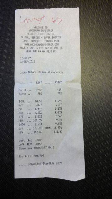

Went back top the track and made a couple of pass's.
The good news is the stumble is gone completely.
The 60 ft times have gone down to 1.63 sec.
But my 1/4 mile times were 11.93 to 11.95.
Ran 3 pass's and they were all right there.
Speed was 111 and change.
Shifted 1-2 at 5400 and 2-3 at 5600 and going threw the traps at 5800.
I guess it's time to put on a larger carb than the 750.
The car doesn't fill like it wants to go over 5800 rpm.

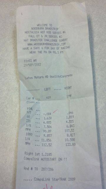

Here's the time slip.
The car picked up et and mph.
Still gaining.
The other car ran 10.50's look at his 60 ft times.
Ladder bar car.
Sound like it wants more carb to me too... the 750cfm {or even the 850cfm if you can still get it} can still improve it even more, yep maybe with more acc. pump discharge squirter, more acc. pump cam, more jet's, possibly different &/or better flowing metering blocks, at a combined minimum... the 850cfm to 950cfm tunned correctly would probably be the "right carburetor" size, it looks like to me.... I had an old Holley DP 950cfm 3-bbl, that I loved, I sold it many years ago now, to an old racing buddy, he still uses it today, I went to a Dominator at the time, wish I would have kept it, but the 1050cfm Dominator, investment worked out well thou...

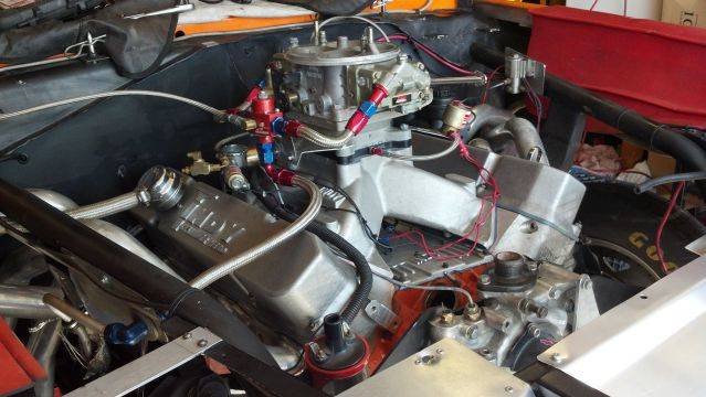

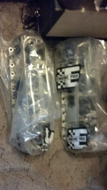

The new year has arrived and it's time to up date my Charger.
Still shooting for the 10's.
I'm taking the stock Eddy's off and putting a set of Edd'y that flow 42 cfm more than the stock one's.
The worked over Eddy heads have 75 cc's so that will raise the comp ratio from 9.52-1 to 10.44-1.
Changing the cam to an old comp custom cam #23-000-5.
.607-622lift.
Changed the carb to a 950 Quick Fuel Q carb.
Going to keep the the 3.91 gears.

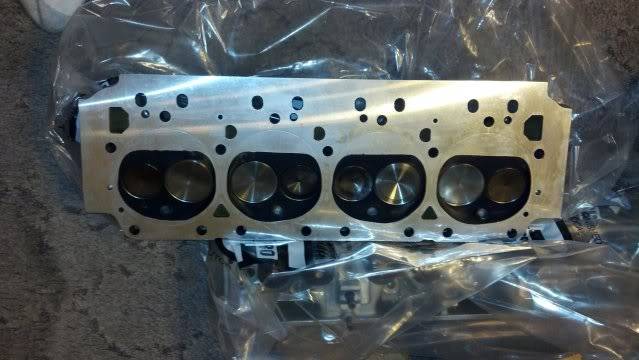

Made a mistake on comp ratio.
Pistons are a -17 cc dish not -27 cc dish.
So my comp ratio was 10.15.
Now with 75 cc champers the comp ratio should be 10.93-1

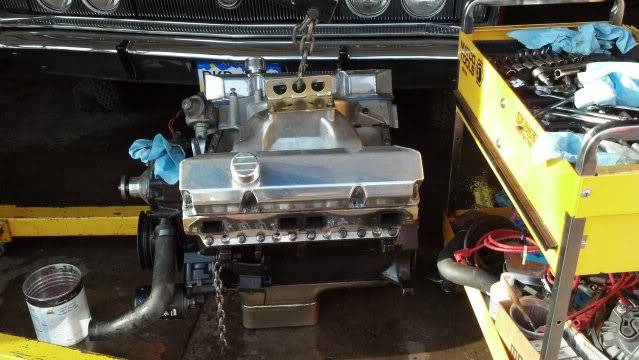

Engine out of the car.
Not very good picture,but here are the ported heads with 75 cc chambers.
Well I removed the old engine and trans.
Took the headers to be re-coating,side note here they charged me $200 to remove the old coating and $300 to coat them.
Engine and trans I was told had under 100 miles.
The trans was supposed to be rebuilt with kollen steels alto bands kevlar bands and bolt in spag and to my suprise it was.
My tranny sponsor tore it down and gave it a clean bill of health and the only thing we did was installed a Cheata manual valve body.
It has a 3000 stall convertor.
Took it to the track a few weeks ago and it ran a 12.3 second pass at 111 mph falling off at the b1/8 th mile.
Next 2 pass's it ran in the 13's.
Put in on the trailer and took it home.
Why run a broken car.

Nice...
I admire your perseverance. How much does this thing weigh? My bet is 4100+. Your gonna need a fair amount of cam,compression,gear and converter to hit your goal. My bet is 3.91 isn't enough. I'd bet 12-1,[email protected]" cam,5000 stall,4.56. Or lose 500 lbs
