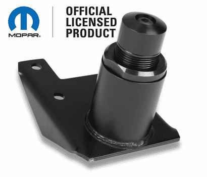

these 2 newer version from Mancini Racing

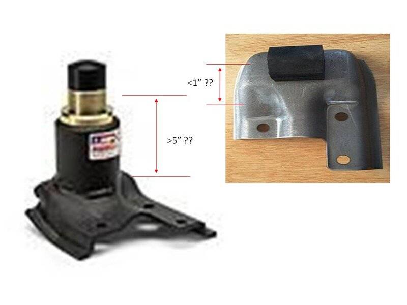

I ran one "sort of" looked like this below on S/S springs,
my car sat much higher
I want to say it was shorter thou IIRC
it was an old Direct Connection part #, no photos or part #'s of it now
right out of MoPar Performance Chassis 9th Edition book
Thanks, I'm asking for the OP to benefit and because my buddy really found it helped him a lot.
NOTE to the OP, the following is for a Dana 60!
I got this one from Mancini, and bent it on the first launch to where it was barely rubbing on the yoke. 2nd run it bent more and rubbed so bad I shut down and looked (the first time I couldn't tell for sure) jacked the car up and removed it.
Knew then I needed new leaf springs. I had no idea the springs were wrapping up so badly!
This one on the left ("factory style" on the right) looks nicer than the Mopar/Mancini one which looks like most $60 ones that are "out there"
Then there's this one you posted from Mancini that looks nice and has very fine adjustments. I can't find it on the Mancini website, but I assume it's for the 8¾?

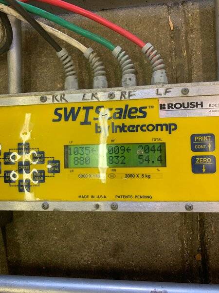

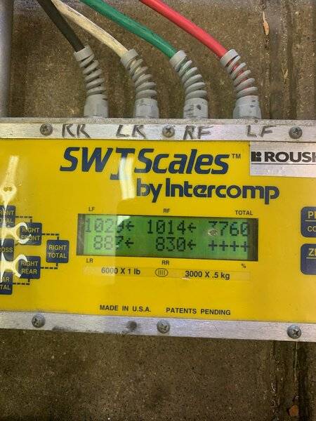

My Challenger is 3760 in full race/street trim at 54%. Depending how much power you are making. Today's higher horsepower vehicles are adding more nose weight to help keep the front ends down from power wheel stands.
What is your weight bias front to rear? Had lots of problems getting a big block Challenger to be consistent that had a lousy weight bias and finally just installed ladders and ding ding ding.
52/48.
