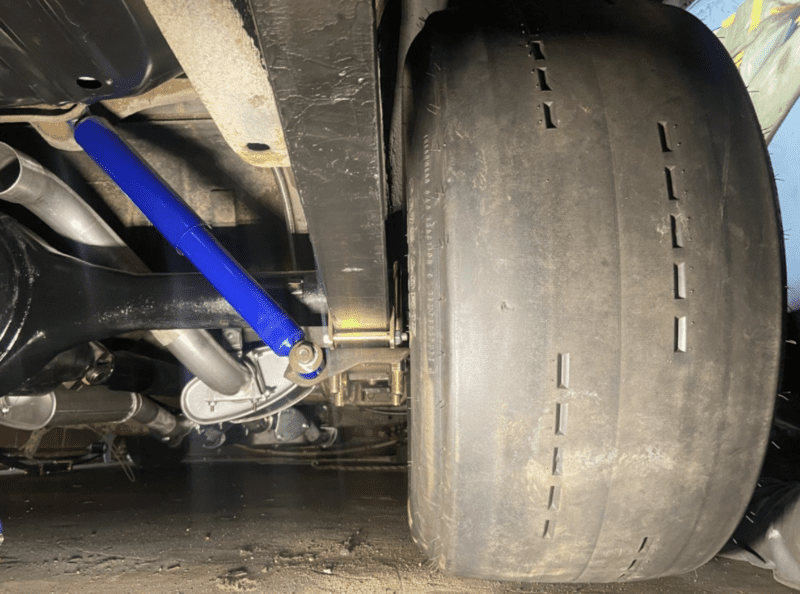

actually a bit more power, and I do agree with the are they necessary. My 4000# with me 69 road runner goes in the 10’s on some factory bias springs with nothing trick at all other than drag shocks and an adjustable snubber. Anything can work with enough tweaking, especially at the slower ET’s. But, I do like the caltracs, they work well without modifying the car. I wouldn’t bother with them on a 13 sec car but if I had a very tire limited 12 sec car I may..
