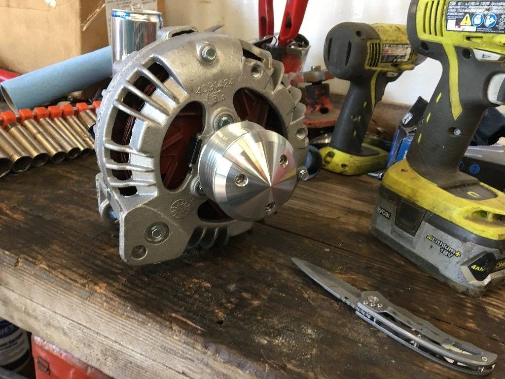

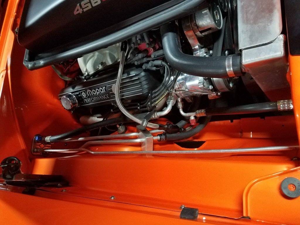

I didn't hide mine but just kept it nice and neat. Where I live under the fender installation isn't a great idea, needs to be easy to clean. This kit makes a clean installation easier having the A/C pump mounted where the lines need to be and keeps the engine free of clutter.

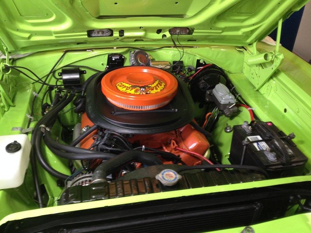

I agree. Plus, since the compressor lives under the hood there is no way to completely avoid A/C plumbing under the hood. Since I was going for a stock, non-A/C look, I sorta flopped my rubber lines with the heater hoses so it blends in a little bit. It won't fool a purist, but it is not obvious that the car has A/C...
Where is your pump, low on the driver side? Looks great, I hate dirty messy engine compartment which yours is not.
Where's you pump, low on the driver side? Looks great, I hate dirty messy engine compartment which yours is not.
The compressor sits under the alternator - it is nice because it really is hard to see. The drawbacks are that (a) you cannot use a mechanical fuel pump because the compressor sits in the way (for me this didn't matter with the trunk mounted fuel pump), and (b) the compressor is driven off of one belt, so it has to be "tinkered with" to be quiet. But I love the overall package. For me, I wanted to have the engine compartment look as stock as reasonably possible, so the fuel injection is hidden too.
