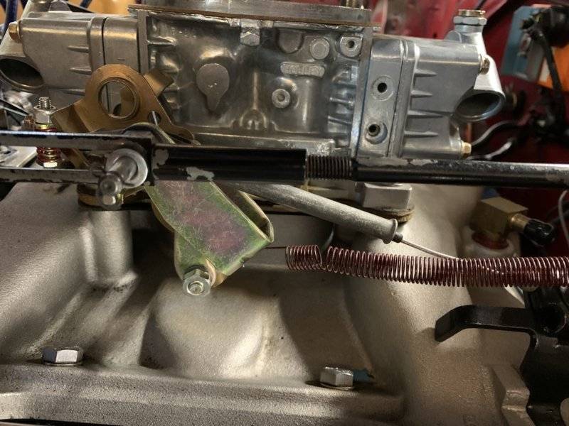

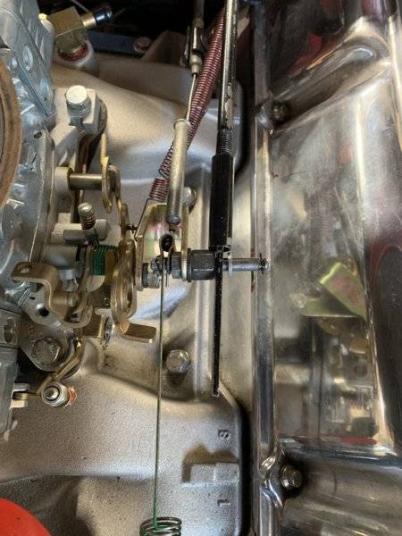

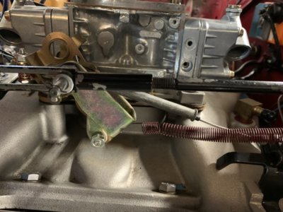

Update....
here’s what’s I did
-adjust fuel bowl levels , they were low
-adjusted air/fuel ratio for best negative vacuum. Leaned it out from the factory setting of 1.5 turns ccw.
-installed the Holley offset bracket, put throttle and KD linkage where they are supposed to be.
-adjusted kickdown linkage.
results....car kicks azz now. 2 to 3 shift issue is gone and car just keeps going. From a complete stop if I step on it, it will break them loose off the line. Car seems to be performing a lot better.
seems like when I had the kickdown linkage spring hooked up next to the kd bracket that my throttle return spring would not return all they way leaving the car running higher rpm at idle. So I put the kd spring back where it was originally and the problem is gone.
see photos of new set up.
thanks for all the help.
67C63A3E-0922-4BA9-8DFD-4C0CC5EB8198.jpeg C71A3625-CFB9-4329-A142-961E25823DDF.jpeg
I had the same problem when using an "factory correct" throttle return spring, which is not strong enough.
I had installed a double spring and solved the problem.
