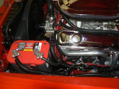

Here is mine, which was meant to appear completely stock aside from the headers ignition and edelbrock intake.
Show off's!! Those engines are so clean you could eat off them, lol!!
WoW
I`m pretty sure I have never seen any engine bays any nicer than those ! Show quality,for sure. Nice work ,guys.
