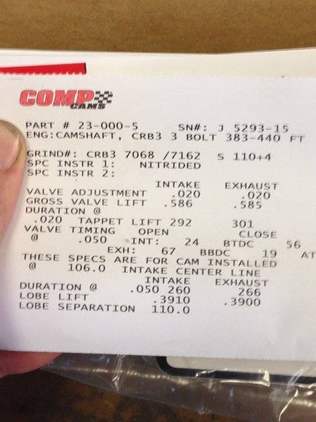

Very similar to the combo in my roadrunner. I’m just a bit heavier at 4000# (with me in it). PRH had comp grind a cam for my combo. Excellent running SFT. It’s a dual pattern. Honestly when I wear it out I may re-order this cam, it’s gonna be damn hard to beat. I use 1.6 rockers on it.
The spec on that cam should be a good match I believe. I have 1.6 rockers to, .624 lift is little more that I have now. Is it easy on the valvetrane?
What lifter do you run? EDM?
Yes easy on the valvetrain. Don’t think I’ve had to adjust any valves in 2+ years. And it gets driven a lot and hard. I have Howard’s EDM’s on it. Dwayne used Ford lobes so it’s not as hard on the cam lobes for street use. We chose a little better durability vs max ramps.
383 man runs the same lobe family on his cam in his 493 as well. His would be “up a size” at 264/270. Probably a good choice as well.
I like a what you say about ramps, that is exactly what I looking for. I usually go over my valves once a year, but that is often unnecessarily.
Was the nitrided a good choice? I have read different opinions about nitrided.
It was worth it to me, I’d do it again. I don’t have a whole lot of faith in more radical flat tappets so I prefer extra insurance.
