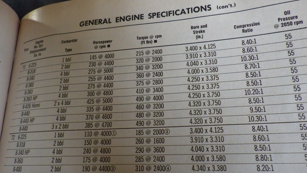

Some 440 specs worth noting I think...........................
I'm not sure but I think the recommendations for 383 was to use the 340 six pack carb set.
