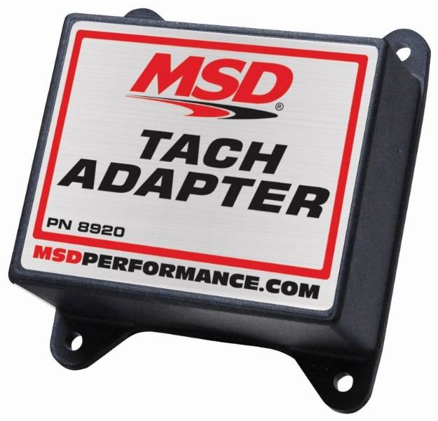

You will more than likely need a MSD tach adapter. I had to have one for the road runner because with the sniper alone it was showing 4000 rpm. tach adapter corrected it.
The old school tach is analog and the Sniper I think uses square wave signal. So it wont read correct. Like I said it was showing 4k on the factory tach before I put the MSD in line.
