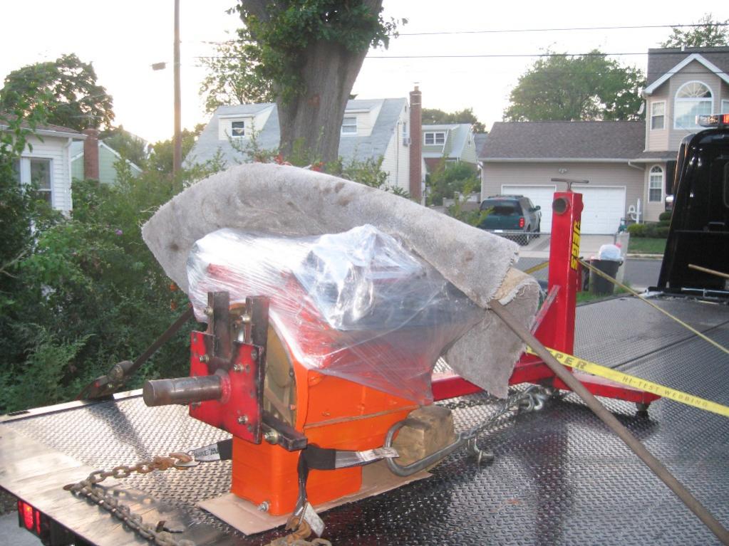

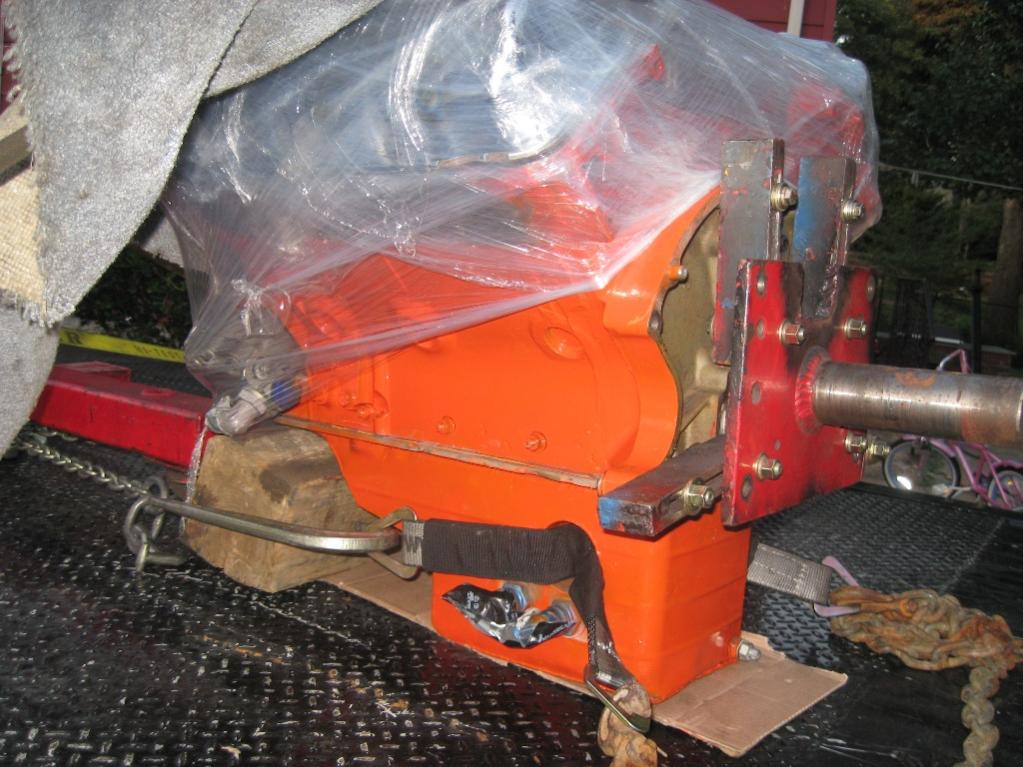

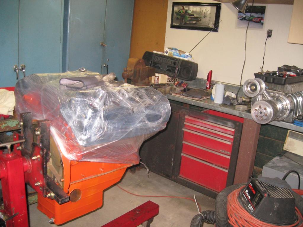

So I was wondering what you guys would do if you have used a engine builder for about 3.5-4 yrs and have given him 10's of thousands of dollars to build your motors, do all your chassis work, electrical rewiring, and rebuild your transmissions only to find out that in each and every case where he performed work for you he made rookie mistakes.
Its not that he's a novice or doesn't know what he's doing, but always in a rush and always paying peter to pay paul.
Well the icing on the cake is when he built my 588 indy motor with all the best parts he recommended and sparred no expense in the engine build.
megablock rb block, gas ported JE pistons,cam motion roller cam,TD Roller rockers,Callies crank,indy 572-13 cnc aluminum heads and only to find out the hard way that he never checked piston to valve clearance and miscalculated the compression on the motor and catastropic failure occured.
So my question to you is all now that all trust has been lost and after after being lied to you over and over about things being ordered and juggling money and things taken way too long to get finished what would you do since $13,300.00 has been lost due to a rookie 101 mistakes.
The problem is I brought the motor to get fixed by Best Machine in Mi.
and the Premier Engine Builder wanted to fix it but I lost all trust and I know it will be a nightmare again getting the motor fixed in a timely manner and I can't afford any more mistakes.

JIM, every valve hit both intake & exhaust, he milled the heads way too much distorting the valve angle.
#8 EXHAUST VALVE broke at the top by the tulip and jammed in sideways smacking a few holes in the #8 piston.
cam, rods, all ruined.
