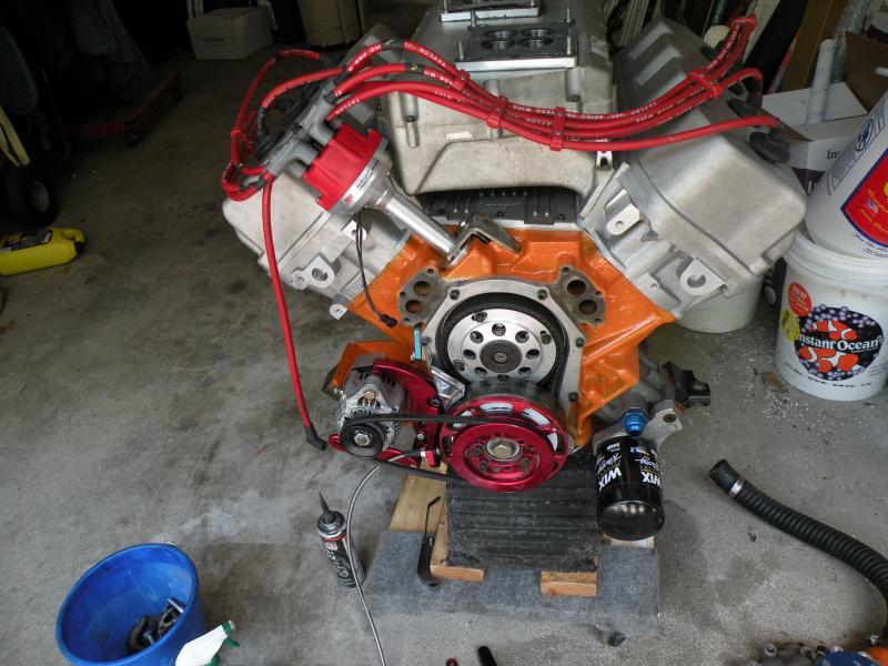

The wedge pistons that you saw were wrong, he put in 440-1 pistons instead of the correct 572-13 pistons. 572-13 have a 13 degree valve angle where the 440-1 heads have a 15 degree angle as you know. That was a mistake which i am over with.
But giving him another try with my hemi after the 1st attempt on the hemi deemed almost the same results. Smoking and slowing down weekend after weekend.
Went from a 9.69 to a miserable 9.98 and in bad air 10.04
Funny i have the build sheets for the Diamond Hemi pistons and it says upgraded wrist pins but upon disassembly it seems to have stock wrist pins.
