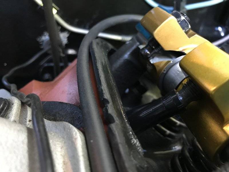

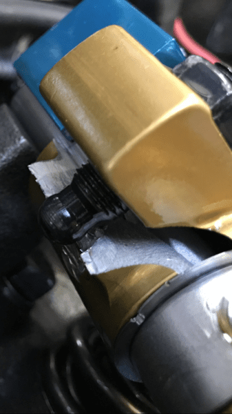

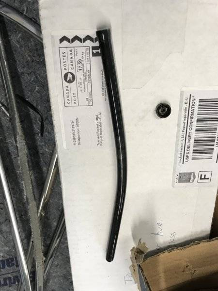

Driving home after a 96 hour shift. Just putting down the road. Horrible noise. Shut it down immediately. Towed home and found this. Still in investigation stage. Looking a Harland sharp and smith brothers push rods. Possible coil bind. More info to come. Less than 500 miles.

Something definitely wasn't right... Sure woulda been nice to find that before running the engine...
Whats the build specs?? Pushrods were way too short... maybe hitting the tunnel on the way down at that length. Also, it looks like maybe the broken cup made contact in a bad way and broke the rocker. HTH, Lefty71
An awful lot of thread showing on those adjusters !! And those don't look like HS rockers to me ... wrong color - those are gold, HS's are copper colored
Aw man that's a major bummer. I hope there's no bearing or deeper damage. I doubt it would have been coil bind, unless all your springs were right on the edge of it?I'd look at each lifter, pushrod length and valve adjustment carefully..And looking at the other pictures, Stanton and Lefty are spot on, too many adjuster threads showing. So either the pushrods are way too short and/or you had way too much preload (if hydraulic lifters). With the adjusters out there now 0-1 thread is ideal.
The rockers are crane gold 1.5s. Not sure on brand of push rods. I was saying I will be upgrading to Harland sharp rockers and smith brothers pushrods. Motor is a 71 motor home block, just cleaned up walls. 10.25/1 CR, bullet solid roller cam. 906 heads, m1 intake, qft 750, Doug’s 1”7/8” ceramic coated headers.

Pull the intake and check your roller lifters . I did the same thing, too short pushrods, gacked a pushrod, flipped one roller of the pair out, the other turned and chewed up the cam. I had to regrind the cam and get a new pair of lifters. Coincidentally (or maybe not) i was using crane gold rockers too.
Edit. .200 longer pushrods solved my problem.

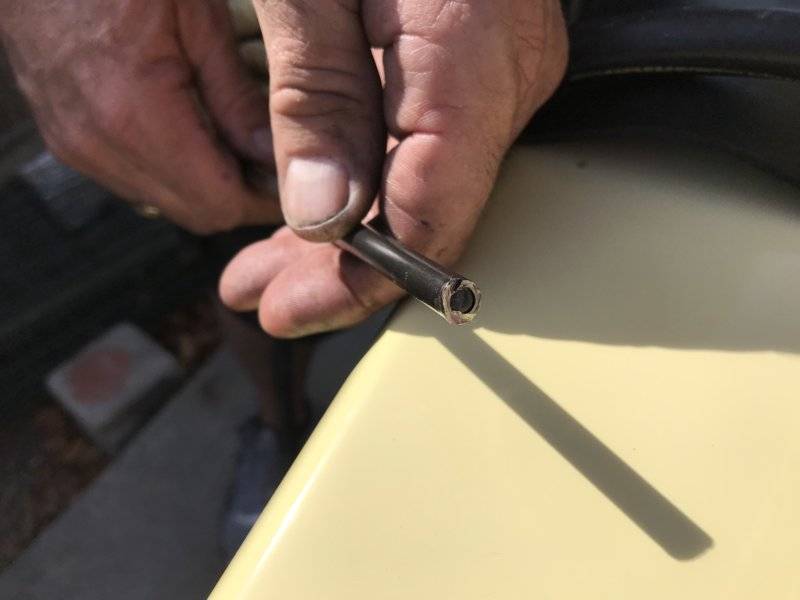

In the pictures what is the little black disc? Is it part of the pushrod?
If the pushrod is bent but complete I'd hammer it straight, cut about 1.5" out of it & thread the two remaining ends... Add so all-thread & there's your length checking pushrod... Exactly how I made mine...
