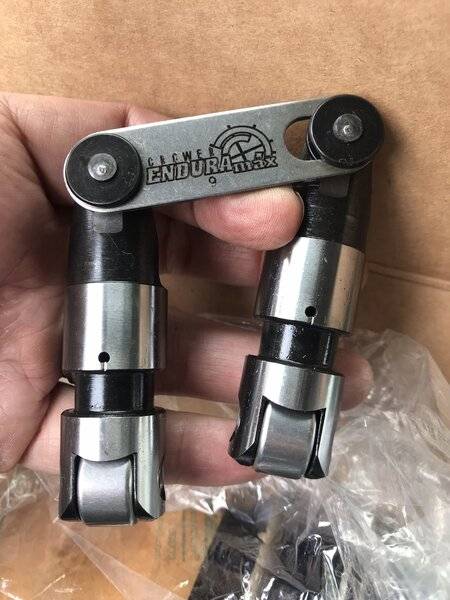

I actually went with bushed rollers for my HEMI this go around. Up till now it’s always had 829’s. These crowers also supply oil to the wheel. Not a cheep date..

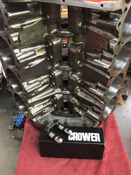

View attachment 1008916 View attachment 1008917
They look short,,,,will they fit w/o hitting the lifter boss? Had that issue with the Red zone lifters! After that experience I will NEVER use Isky for anything!!!!!!!:cursin:
