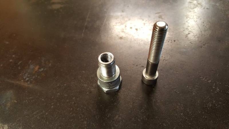

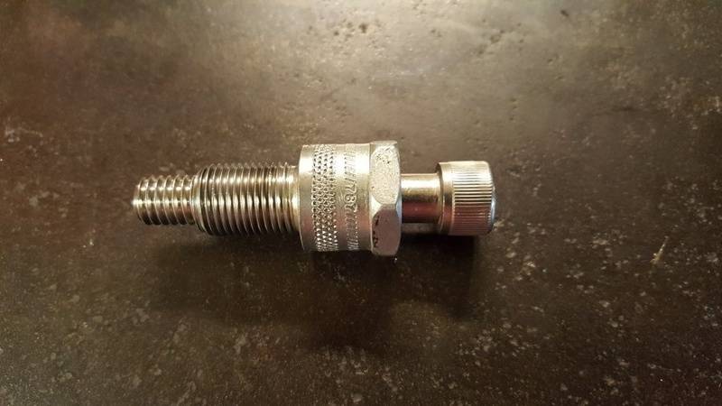

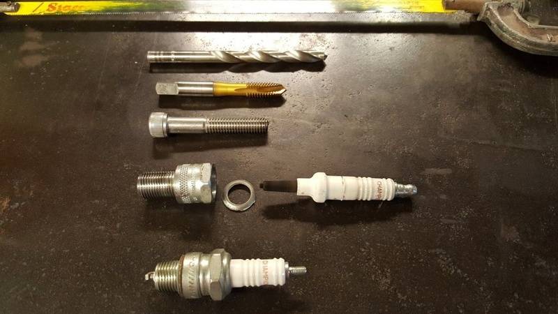

Made myself a Piston Stop for finding TDC with the heads on. Things you will need:
Long reach spark plug
3/8 x 16 x 2 1/4 bolt
Hack saw
5/16 drill bit
3/8 x 16 tap
Cut the shoulder that's holding the porcelain all the way around. Don't saw straight through. Turn the plug as you go, stopping when you hit the porcelain. Tap around the hex on the plug to release the glue that's holding it in. Cut off the ground strap and tap the electrode and porcelain out. Also remove the sealing ring on the threads.
Useing a 5/16 drill bit, drill through the center. The inside diameter is already 5/16 but there is a shoulder halfway down. Follow up with a 3/8 x 16 thread tap.
Use a 2 1/4 bolt with at least 1 1/4 of thread.
That's all there is to it
To use the stop:
Remove all the spark plugs in the engine.
Find the piston top, by turning the crank by hand, useing a wire, or what I like to use, a plastic wire tie, in the #1 plug hole. Try to find the TDC by hand first before inserting the tool. Then back if off just a little. Then insert the tool with the bolt backed off. Run the bolt in until you feel it just touch the piston. Make a mark on the damper.
Now rotate the crank in the opposite direction until you feel it touch the stop. Go slow and let the compression bleed off. When the piston contacts the stop, make a mark on the damper.
Half the distance between the marks is your TDC.
Fine tuning where you set the bolt, can narrow the distance between your marks. A little practice and patience will get you good results. Great for checking your dampner's accuracy.
Or you can buy one. You just need to know your plug size...
https://www.summitracing.com/parts/pro-67581/

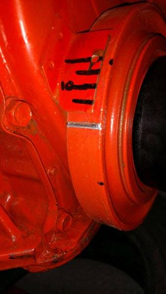

Here's a pic from when I learned all this stuff on my own 440:
The "10" on the timing marks is 10 degrees BTDC; notches on either side are the 5 degree increments
either way. The factory hole in the timing mark plate is TDC indicated.
The two black dots on the balancer were where the piston stop hit the #1 piston in either direction
of rotation. The silver line on the balancer is the factory grooved mark, which in my case proved to
be exactly accurate for true TDC.

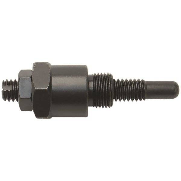

I used a piston stop from Summit:
https://www.summitracing.com/parts/pro-67581 pro-67581_xl.jpg

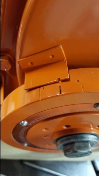

I did end up finding the timing mark after scrubbing all the crud off (my balancer has a single mark on it) and verified TDC by pulling the valve cover, plugs and using the old welding wire trick.
