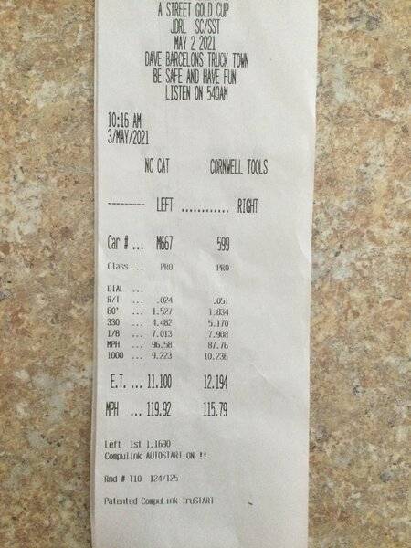

Looking at Dwaynes slide rule above, it looks like I’m getting just about what can be hoped for out of 119mph power, which makes me feel good about the work I’ve done with the car over the past few years. After all the time and $$$ I’ve sunk into this thing this year, there’s probably no more big changes coming anytime soon. 10’s would be cool, but I’m ok with where it’s at for a while. I think it’s a damn competitive bracket car, and I’m feeling pretty good about my abilities behind the wheel these days, so I’ll most likely just focus on trying to win some races for a while.

Wallace has an "ideal" calculator on his site, supposed to be the best that can be expected from a given number. It says your 11.10 pass would have a 119.3, your 119.9 could be as good as 11.05, so, in my opinion, you are right there! Looks like it needs maybe just a little more power, or a little less weight for 10s.
Are you 7.0s at around 97 in the eighth?

Why yes, I am! 7.01 @ 96.58 on this slip. I’m pretty sure it’s touched 97 in the 1/8 in the past. I could be wrong though.
That’s a Hellcat Challenger in the Right lane, by the way. Arent they supposed to be stouter than that?

Wallace ideal says your 7.01 1/8, should go......
11.11 at 119 and change. Pretty close to ideal if you ask me! Congrats!
And we have some hellcats faster than that.... and some slower. Like any car, depends on the driver, and the tuner.
We've got a local guy (a real life homer simpson, but a smart nuclear engineer) who's had two cars on the cover of mopar muscle. His hellcat was good for mid 6s eighth, sold it, now has a single seat Demon. Its faster.
