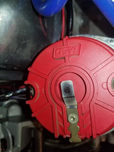

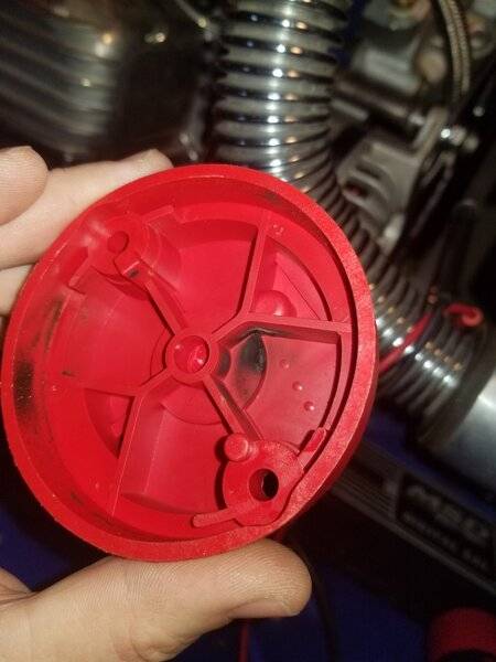

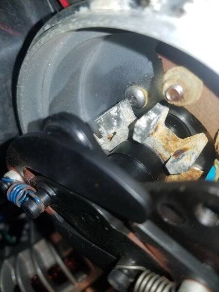

It was never the rotor. When you look at the pic & see where the rotor blade is positioned, the black mark on the underside of the rotor does not line up. For it to have punched through the rotor, you would expect to see a black mark on the top of the rotor, to the right of the blade.

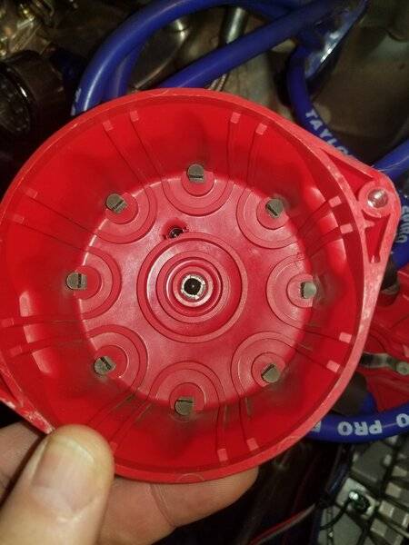

The red material is not bakelite, it is Rynite which has very high dielectric strength, better than the biscuit coloured Alkyd that was used previously.

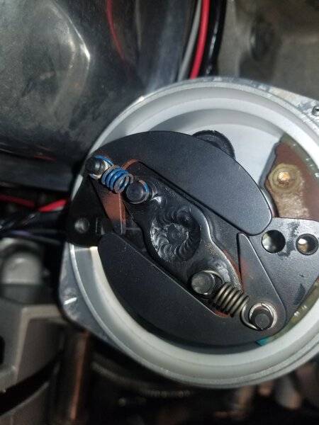

The only 'electronics' this dist has is the p/up coil. Rarely do these fail electrically, such as grounding internally or go open circuit. Check the air gap, should be 0.010"; make sure none of the rel tips make contact with the p/up coil; rusty reluctor will not affect operation.
If this checks out, look at the coil, ign box or module & check supply voltage to the box.
