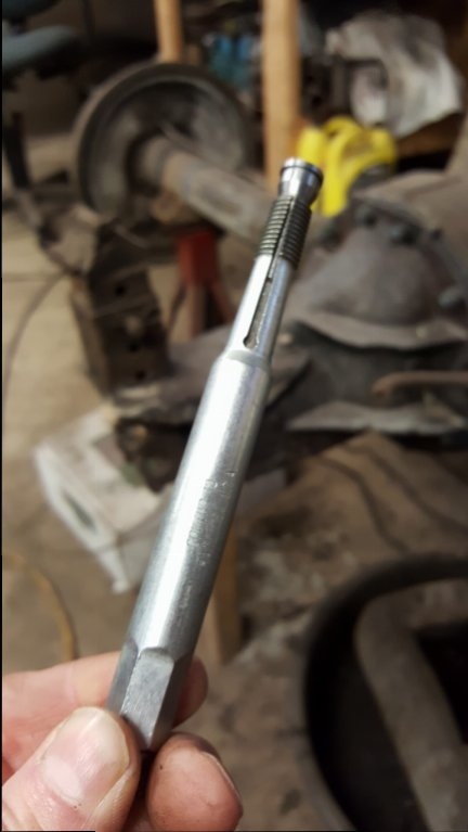

Same on my boat's merc. This tool saved my butt.
