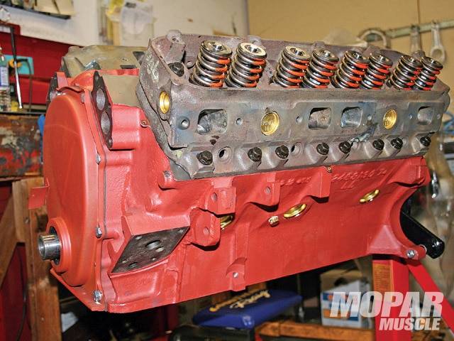

Grabbed this from another site. Heads and their comparison.
516, 1966 and earlier, Flat Port Floor, Closed Chamber, 2.08" Intake / 1.60" Exhaust
915, 1967 only, High Huber Hump Intake Port Floor, Closed Chamber, 2.08" Intake Valve / 1.60" Exhaust (low perf), 1.74" Exhaust on HP Engines
906, '68 to 1970, High Huber Hump Intake Port Floor, Open Chamber, 2.08" Intake Valve / 1.74"Exhaust (All)
902/346/452, 1971 & up, Low Port Floor W/swirl hump on siamesed inner Port wall(acts like a short turn), 2.08" Intake, 1.74" Exhaust(All)

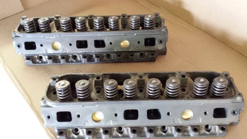

No I am not mixing up the issue. lol I was showing him that the intake and exhaust are the same size as the 906 heads. He was thinking he was bamboozeled with weird heads. Also that the heads are just a later date head. I also told him that the larger spark plugs will not fit in the heads. I had the same heads and the same plugs and they would not fit. I was reassuring him that the heads are fine.
I posted the pictures of the 452's compared to the 906's above. I know the issues because I had the issues. The bump out is the issue as I stated.
I just wanted to say thank you to the FBBO members that responded to my problem. I just wish the company where I bought the motor should have at least specified the heads they were using. At first i was thinking stripped threads in the head( motor, not my head???)
They are probably 452 heads that have the bump out and wont allow the larger spark plugs. Same issue I had with the RV heads. I should have had the guy mill the heads in that area. The bump is aright next to the spark plug hole sand only allows the smaller shanked plugs.
452s with the bump.
906 without.
