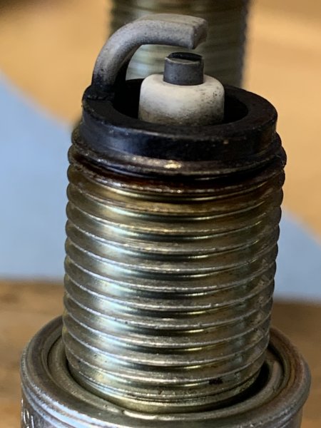

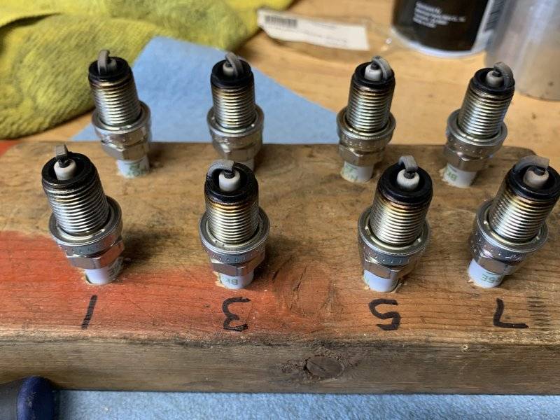

How far off am I? These are ngk bkr5e plugs I just swapped in some bkr6e plugs.
440 10:1 tf 240 heads pump has 90 ethanol free.
These plugs have been in since I started, broke in engine and before I had it idling on the idle circuit properly. The carburetor is a 4778-8 700 cfm Holley dp stock jet sizes 69 and 78 rpm dual plane intake
I was told that the base of the ceramic is best to determine the color not at the tip by center electrode
It looks a hair rich, also, you went to a colder plug with the 6's. Heat range looked about right, 2-3 burn on the threads.
