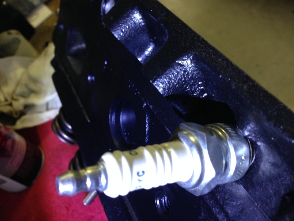

This is a weird one...in final assembly of engine and tried to install the plugs to keep things clean inside. None of them will go in... neither used ones or new ones. The heads are 452 castings. A plug thread chaser goes in fine, a compression tester fitting goes in fine but not the plugs. Tried the old champions and a new set of NGK's. Any thoughts, comments or suggestions would be appreciated.

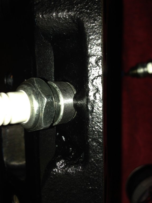

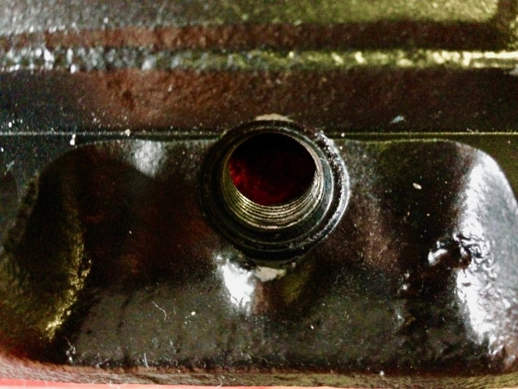

OK...found the problem.
There is a small nub/hump right below the bottom of the spark plug hole. The bottom shoulder of the plug is larger than the space allowed for the plug.
I took an old plug and ground it down small enough to clear the nub and it goes in without a problem.
As I mentioned in my earlier post this is a set of 452 castings...guess I'll grind off the nub/hump. Anyone else encountered this problem before?

It appears that you have the motorhome 452 heads that use the Chevy style taper seat spark plugs with the 5/8 nut on them and not the 13/16 nut gasket style plugs.

This is my 452 head. Plug diameter on the end is .795 almost 13/16. Your plug hole has a taper, my plug hole has a flat shoulder.
yup, those are tapered seat heads, for the smaller 5/8" plug....also known as "motorhome heads"
the 13/16" plug will not work in them
Yep.....looks like they are Motorhome heads. Thanks for all the replys it's been very helpful!
