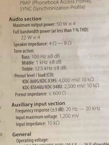

The stereo unit:

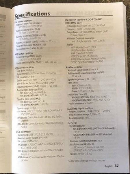

The specs:

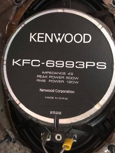

Now the rear 6x9 speakers:
Forgive me for coming across as a little slow, but....
Is it fair to say that since the speakers are rated at a LOT more power than the stereo unit is making, the speakers are just not getting enough power? Would one solution be to switch to a lower rated speaker OR should I rig in some type of amplifier?

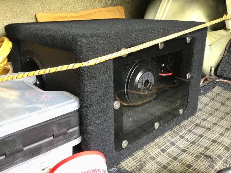

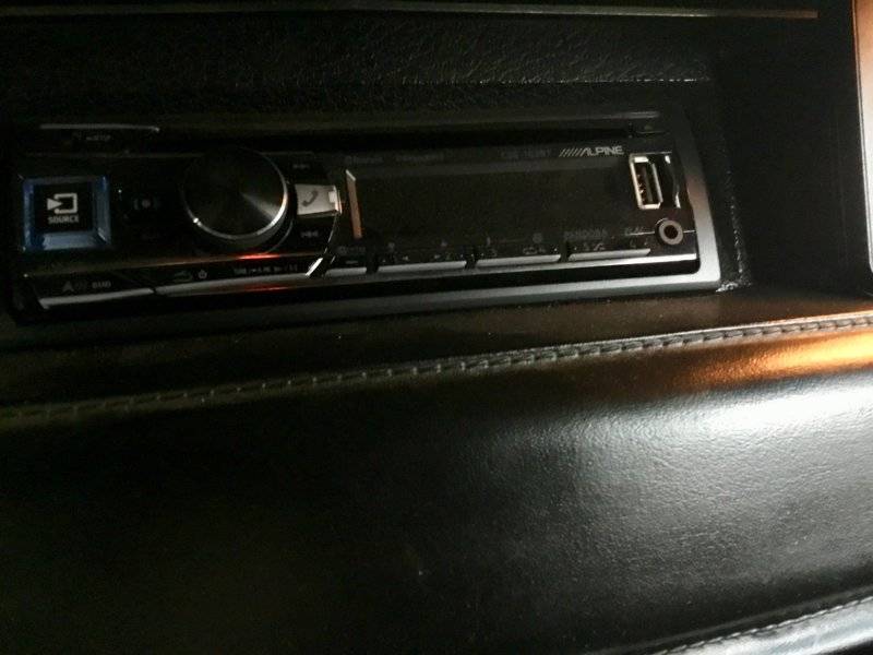

The 6x9’s sound great. Not sure of manufacturer. The Alpine is a good unit, does more than I’ll ever figure out. The boomer in the trunk is the key. Tweeters really round out the sound. Yes it is a pia, thought it would fit under the shelf. Too big. Does the job though, stays secure, and still have plenty of trunk room.
In days of old, speakers were always matched to the amplifier's capabilities in terms of impedance (similar to resistance) like 4, 8 or 16 ohms AND the maximum output (watts) the amp could produce at a specified frequency range. The better speakers had a frequency range of 20 Hz to 20,000 Hz., over a specified decibel range, like +/- 3 to 5 db over a specified frequency range. The human ear can discern frequencies from about 40 Hz to 10,000 - 12,000 Hz......but you can "feel" the extremes. Usually, paper cone speakers cannot accurately reproduce frequencies above 10,000 Hz. Those frequencies are reproduced via metallic devices, which react faster due to their lower mass. The transitions from lower frequencies to higher frequencies are routed thru a "cross-over" network comprised of capacitors and inductors "tuned" to certain frequency to switch between the low frequency to mid frequency to high frequency "speakers"
The other factor that was considered was the "efficiency" of the speakers. The lower the efficiency, the better the speaker system could reproduce the sound but it required more driving power (watts) produced by the amplifiers.

More power is always good.
But maybe a speaker with a lower RMS requirement will work for you.
Max output: 50W x4
If you don't change that amp, you MUST buy the most efficient (dB/watt) speakers you can find, that also sound good to you.
22 WPC is pretty weak, and that is the "optimal" steady output power capability of your amp.
Those speakers are, well...not that good.
Remember this! "It's all electricity until it hits the speakers!"
Really good, highly efficient speakers are THE most critical part of ANY audio system!

Not necessarily....usually at higher power levels, DISTORTION levels (garbling or resonance..booming) occurs when speakers are overdriven and is a squared function.... RMS (Root Mean Squared) is square root function of the peak value impressed, and is frequency dependant. If the device (speaker) is capable of high peak values, then the RMS (or average value) will fall within the acceptable value at the specified impedsnce. Not matching the impedance will result in power loss and possible amplifier damage speaker damage or both....especially at high power levels. An audio engineer (not the Best Buy sales person) would be the best source for information.

View attachment 884832 View attachment 884831 View attachment 884830 The 6x9’s sound great. Not sure of manufacturer. The Alpine is a good unit, does more than I’ll ever figure out. The boomer in the trunk is the key. Tweeters really round out the sound. Yes it is a pia, thought it would fit under the shelf. Too big. Does the job though, stays secure, and still have plenty of trunk room.
This can make the car shake. Is it facing the wrong way?
