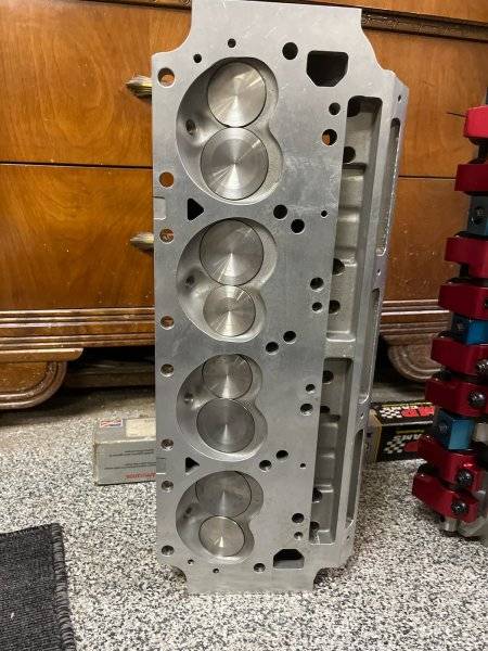

No personal experience, but have never heard much good. My buddy just sent some pics of some he got, and I looked at the valves and said WTF?View attachment 1765018
I think I might turn down the o.d. of either the intakes 9r the exhaust, depending on where the seats are......
Edit: probably turn the intakes (2.19?) and romance the seats and throats.
The valves in the heads in post #5 are the incorrect pieces for those heads.

As has been mentioned, not a good head choice for milder applications where stock intake/exhaust manifolds are a possibility.

Thank you Dwayne, I'm going to send that post to my other friend, who was going to put together the engine for "friend A".
My first thought was the exh valves were too big. Good to hear it's both.
Obviously the diameters are wrong, but I’d be very surprised if the lengths weren’t also too long.
I’d say the fact that the diameters are wrong is enough proof that they need a trip to the machine shop before installation.
If someone were inclined to try one of these top end kits, I’d call and have them tell you what diameter and length the valves are that come in the heads.
Should be:
Intake- 2.20/2.19 x 5.350
Exhaust- 1.81 x 5.375
Lengths should be within .010-.020”.
The ones with the 1.88/2.25 valves will likely have valves about .250” longer……..which are just flat out wrong for those heads.
