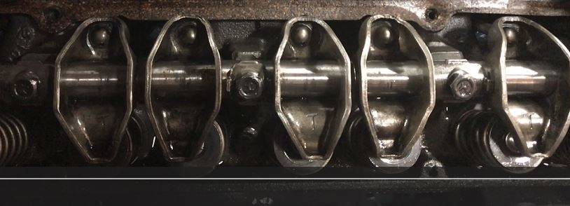

The rocker arms are not interchangeable, they are made in pairs of right and left. Look closely to make sure they are correct, the other problem could be the spacers/hold downs did not get put back in the correct order. If the rocker arm cup is on the pushrod, it shouldn't be far off the valve stem...there can be a slight side-to-side movement. They look correct in the picture you posted earlier

In this picture, the two on the left both look like left hand rockers, then the next two both look like right-hand rockers, and the last one looks also like a right hand.. at least that's how it looks to me in the picture. They need to be, if you start at the far left valve, in pairs L-R, L-R, L-R, L-R. They appear to be L-L, L-L, R-R, R-R (of course I'm guessing on the three that aren't in the picture based on the locations of the ones that are shown) this would be why your tips are not properly on the valve stems
Thanks - Got the rockers on correctly, getting oil as well - however, the original problem with the squeal is still there. Like I said in my original post, checked the flex plate and starter bolts - sounds like it is coming from the top.
