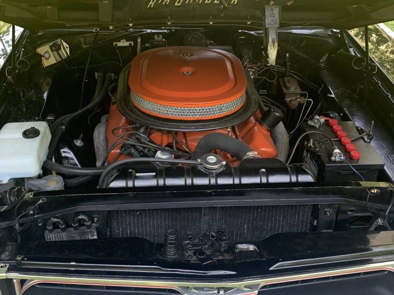

Hi from southern Illinois, This winter I’m going to pull my motor & transmission and redo my engine bay. I have a com-cam 509 lift. can’t remember the other spec on it. I’m running a 3500 stall. I like to do away with the stall. can I go to a factory torque converter?Without changing the cam? Thanks for any advice.
Well...the .509 (in my experience) always did better with some stall. So, if you're set on using a stock converter, a cam change would definitely be worth considering IMO for "enjoyability" purposes. Or, you could getcha a "tight" higher-stall unit like a 9.5 from PTC/Dynamic/etc and keep the cam (since they new ones can be tough to get these days..)...they can set you up with a converter that will flash up to the cam's power band in an instant without feeling loose and sloppy on the street like the converters of old. Just my 2¢!! Good luck. Looks like a fun project.
