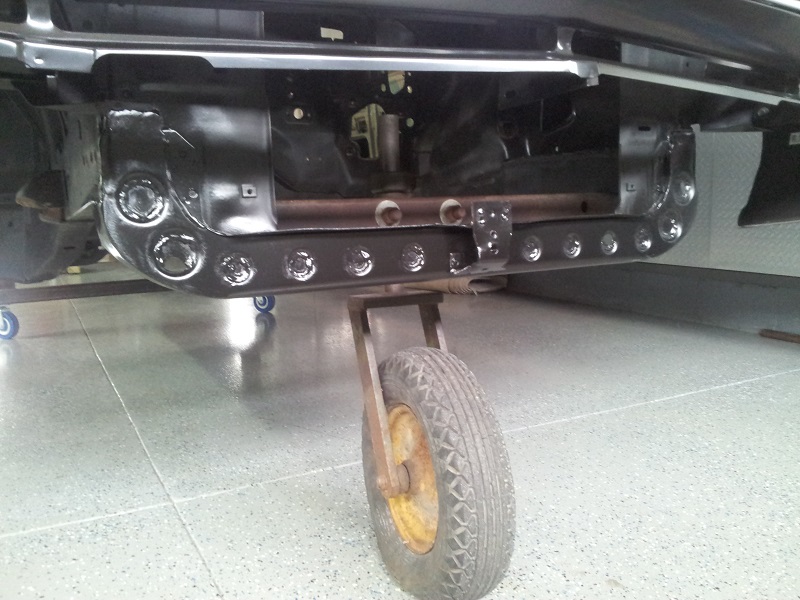

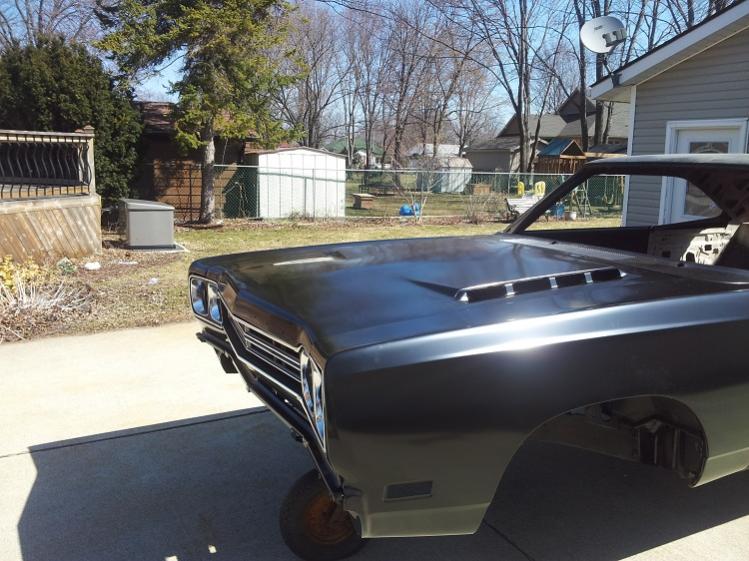

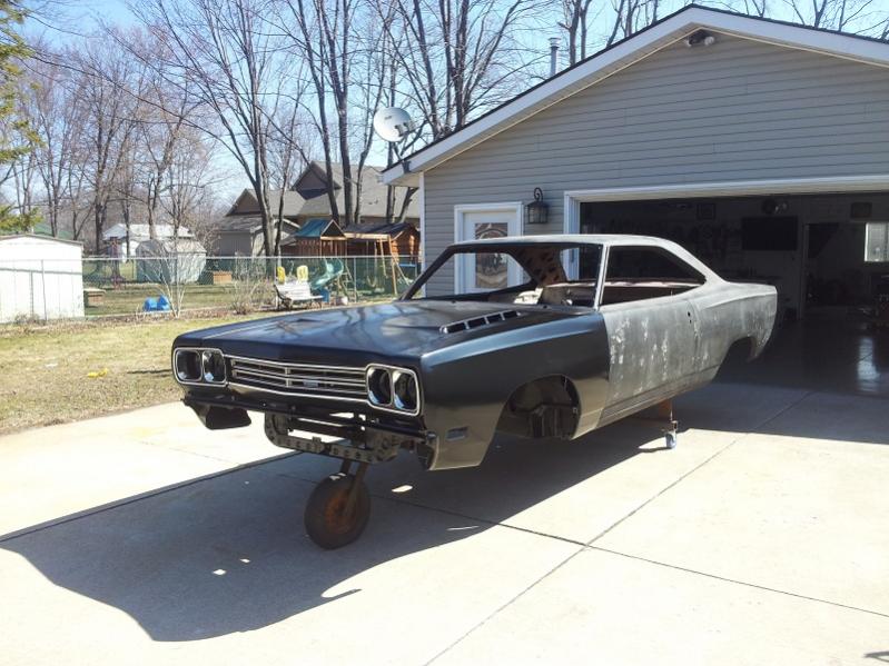

I was wondering if you spent any more time fitting those amd fenders? I'm thinking about purchasing a set this week and they are really expensive, just wondering how the fit is. Also the lower rad support reinforcement from us car tool, does that cover over the existing piece, or do you remove the existing lower section.

hey dean, the fenders I have anyway fit quite well I did have to make elongate the top hole in the back to allow the fender to come in towards the middle of the car(if that makes sense) but they fit and look real nice. the lower support brace I slid over the existing one (you have to drill out the bracket in the middle and install when finished) and welded it all around even the front holes,it made a flimsy support into a pretty solid piece. huge difference, I installed their whole kit for the car glad I did it really stiffens it up. here is a couple pics of fenders and brace. thx bruce

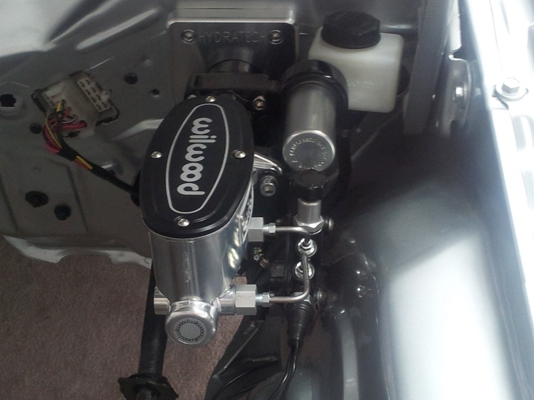

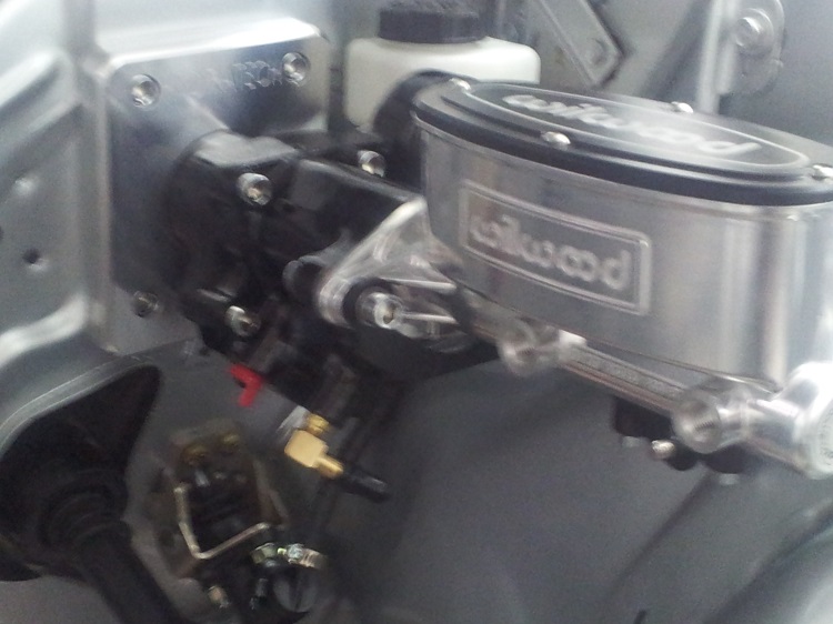

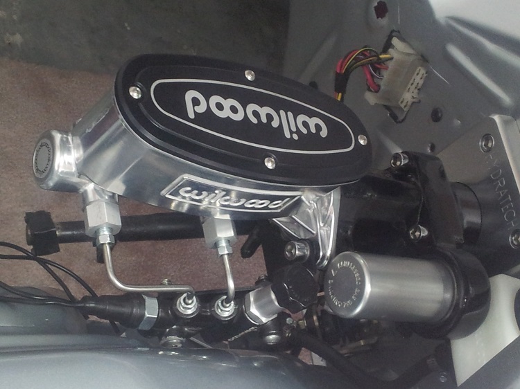

thx Ron,ill see if I can get a hold of moparmarks. challenger is coming little by little,installed the hydroboost and hydro clutch going to order the alterkation very soon but as far as the passon 5-speed it looks like I will have to go with a 4-speed as I don't think my number will come up before next summer and I was planning on having the car done by then. so I will put a 18 spline 4 speed in and change the box at a later date I guess. I am only home 8 days a month so I kind of try to buy and install one thing at a time

Thanks for the update bud! I don't think you can go wrong with the Wilwood equipment, i know Will used it in "the skeltor" and ever since ive told my wife when the time comes ill be needing there "stuff" lol, and now i see you using it which further influences me in there direction, hey im a copy cat type of guy, especially if i know the guys im copying from! I CHEAT! rofl... :)
