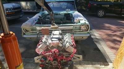

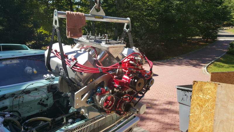

Dropping the Hemi in tomorrow after work tomorrow. Then start chipping away at the small parts and stuff.
Shouldn't take too long.

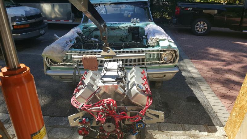

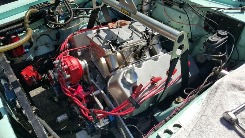

The new hemi is in the engine bay. Bellhousing bolts are in. That's it for today.
No more work till Sunday. Tomorrow is race day.

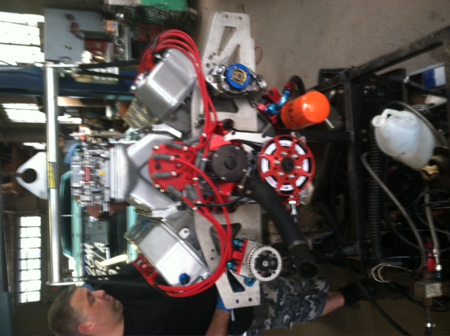

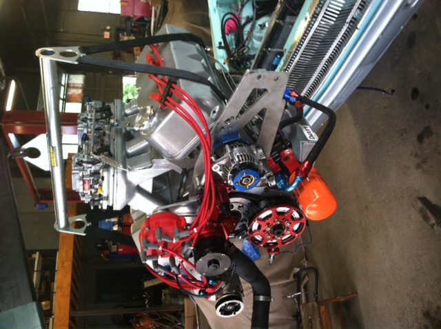

1 more for tonight.

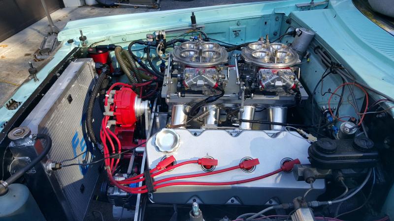

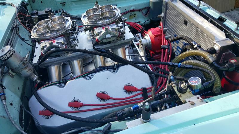

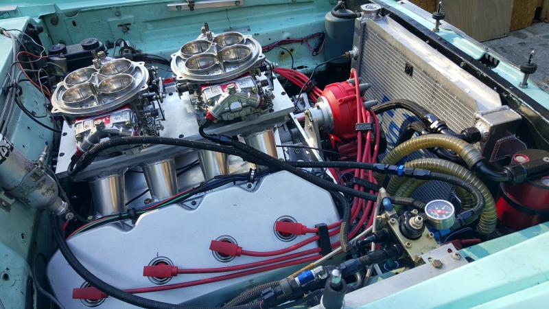

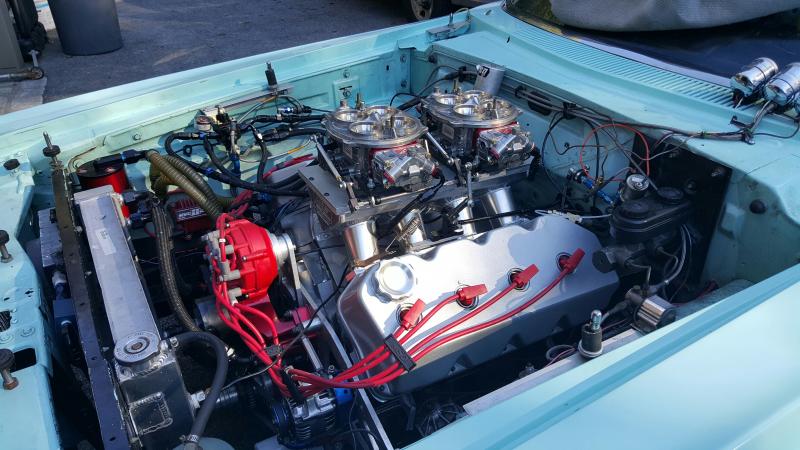

Well it's almost show time!!
