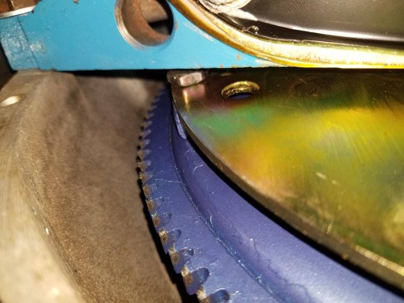

Swapped starter out and replaced with one I know is good. The new starter worked for a few turns then the same symptom, the starter is either not engaging or just slightly engaging enough to turn the engine for a partial revolution. Photo shows where teeth are engaged and the corner of several TC gear teeth are chewed up. I don't have any adjustment as far as tooth clearance, not sure what to try next.

That big fat flex plate could have something to do with the problem perhaps??
Not sure but how thick is that part?

That bolt on flex may interfere with bendix? It could be the picture but flex tight at bolt not in foreground.
I agree with Fran. The ring gear doesn’t look bolted down all the way onto the flex plate. And the teeth on the ring gear look like they are taking a direct hit on the front instead of between the teeth. It also appears the starter is not doing deep enough into the teeth. I would recheck part numbers on everything.
I am using a mini starter. From what I can see, both starters have fit flush against the transmission case. I don't completely understand the comment about the bolt on the flex plate interfering but I will look into it. Can anyone attest to having used one of these thicker flex plates and if they had to make special accommodations for the starter to work?
That's your standard b&m flex plate, they don't interfere.

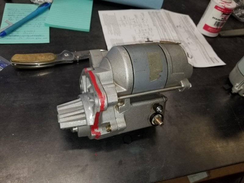

I eventually came to the conclusion that the extra thick flex plate is the culprit. I'm not sure how many would approve of this solution, but until a better one comes along I took 3/16" off the face of the starter mounting surface. Seems to work fine, at least I know the engine runs now!
The B&M flex plates are between 0.010 and 0.020" thicker than stock, I measured a few.
Looks like you cut off the centering nose of the starter. That in turn, allowed the starter to move outwards relieving the "cocked in housing condition".
Now it has less teeth engagement. But if it works for a while that's great.
I would have spent the 4 seconds and put a grinder on it instead.
My heavy duty flex plate is about 3/16" thick. I tried 2 starters with the same result, the other starter did not have a centering nose.
