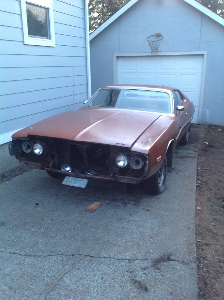

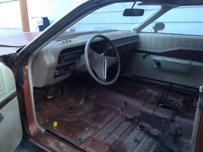

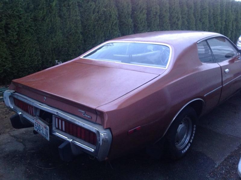

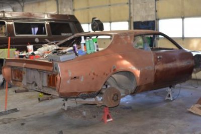

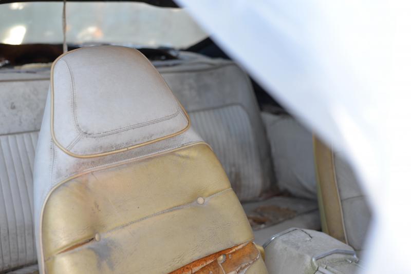

This is my 1974 Charger, that i picked up about 2 weeks ago for $1200. It was a /8-1/4" car. Bought it complete minus the 318. Planning a mild 440/727/8-3/4" for it. This is the beginning stages of the restoration, but as clean as the car is, i dont for see it taking much to restore it...aside from bucket loads of cash :p I will update as i make headway... charger1.jpgcharger2.jpgcharger3.jpgcharger4.jpgcharger5.jpg
Nice charger one of my favorites. And welcome to the site ,there's lots of smart guys on here for ?'s you just have to ask and you'll have some kind of answer prity soon . Agen cool car you need any help just p.m. me I've built almost 10 of that style charger
That looks to be a good solid car to begin a restoration with. :headbang:
@ bb70charger500, yes i am sure i will have questions for you. And thanks for the compliments :)

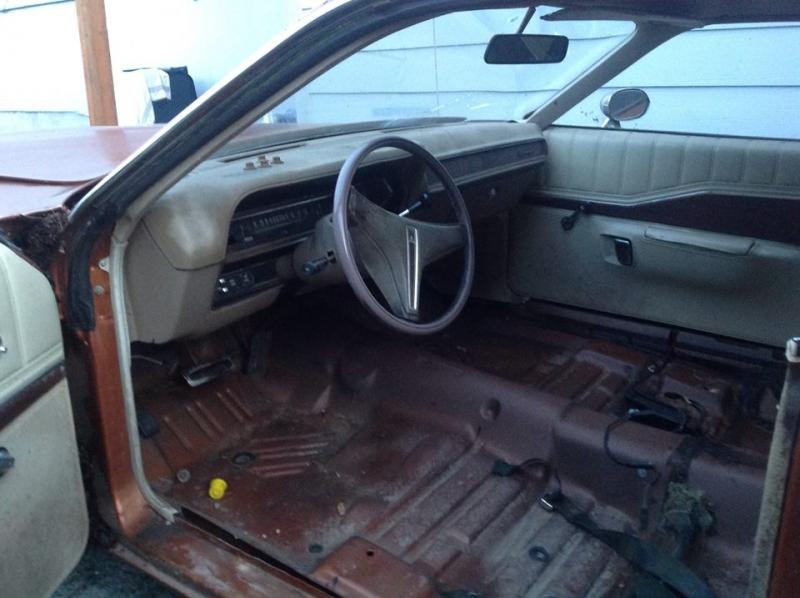

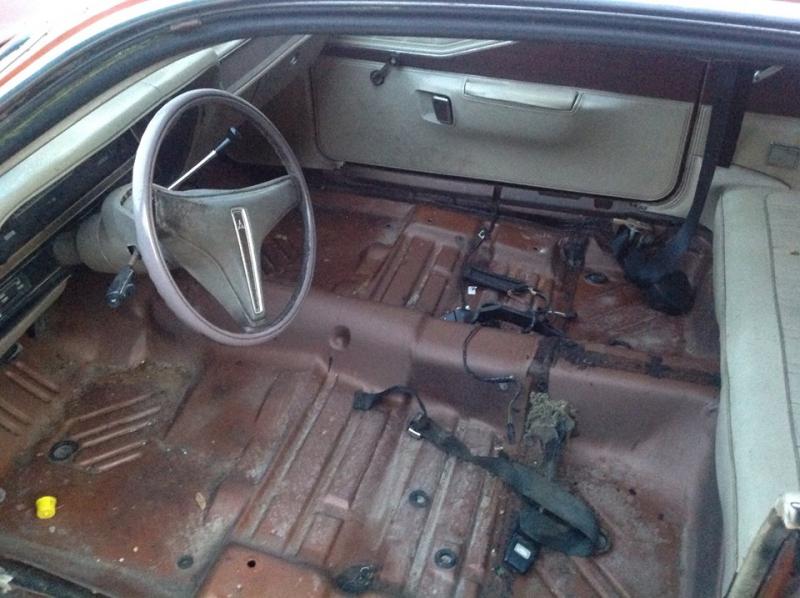

@kiwigtx, yeah man. i almost fainted when i pulled the carpet up and saw the near perfect floor pans. unbelievable for a from the seattle area to be this rust free.....especially considering its been stored outside for nearly 12 years!

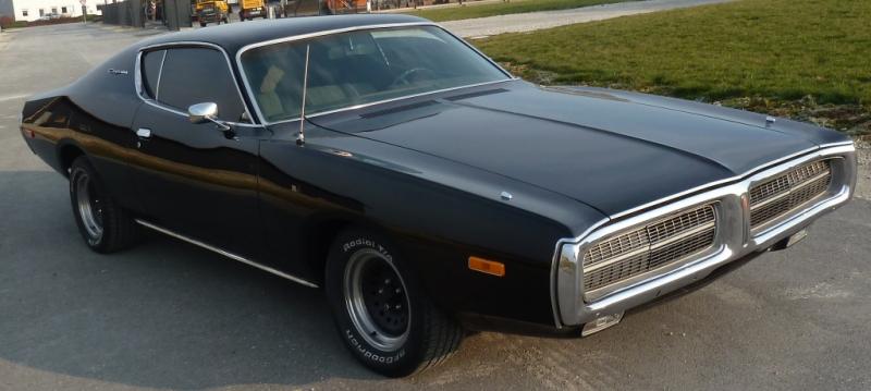

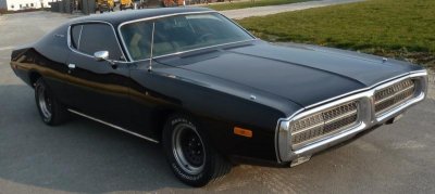

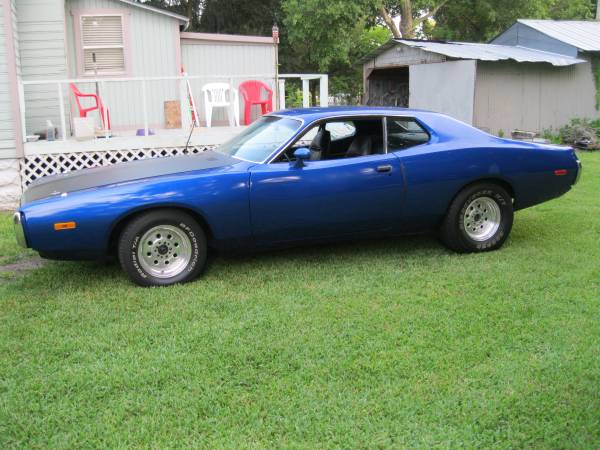

Here's a few of mine (this style chargers)IMAG0547_BURST002.jpgView attachment 2520384837939_orig.jpgattachment-1.jpg00r0r_dJe6W2gh1Wl_600x450.jpg00T0T_4Ec96XaIyxT_600x450.jpg
The blue one was painted after I sold it but it was my first charger so I wanted to add it's pic too. I've had a lot more but sadly I didn't think to take pictures of my cars till recently. Oh well agen any ? Please feel free to ask the gold rallye and black s.e. sunroof car are in for resto right now so I can compare if need be good luck on the build
wow, bb70charger500!! nice cars! One question, i see on the orange one that is being loaded/unloaded from a trail has the rear bumper tucked...how did you go about doing that? Seen a lot of different ways being done on here, but no one definative way...some say slot the brackets, others say but 71-2 bracket (though some say they done fit the 73-4 cars)...hence my confusion. Thanks :)
71-72 brackets, I just change bumper and all not shure if the brackets will bolt up to the 73-74 bumpers (I don't see why not ) if you can't find brackets you could just cut you brackets and take a inch or two out if your going this route let me know I can measure the 74's bracket and the 72's and see how much it is
Oh and thanks these cars are my baby's ,I always switch the 73-74 rear bumper out for the 71-72 (I think it looks much better) but I will say the 73-74 tail lights don't fit without modifying the plugs the wireing comes out horizontal instead of vertical like the 71-72 chargers so keep this in mind you will have a problem when you get to tail light install,and remember any ?'s just ask

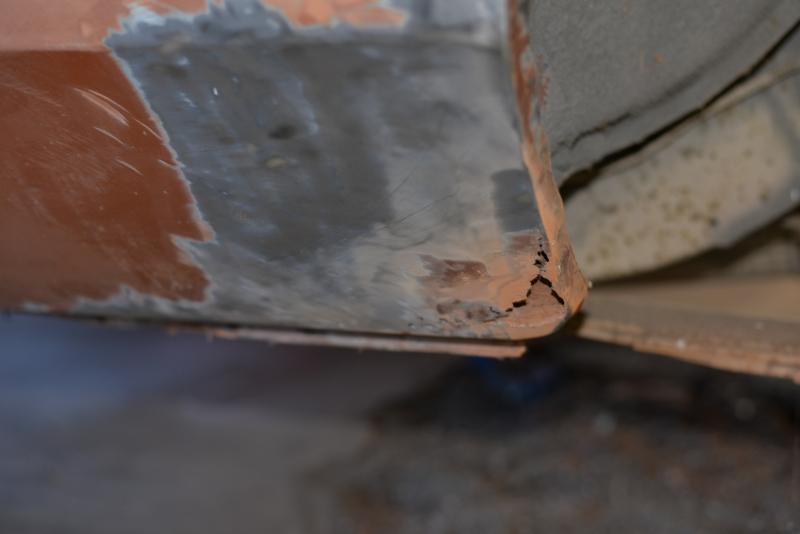

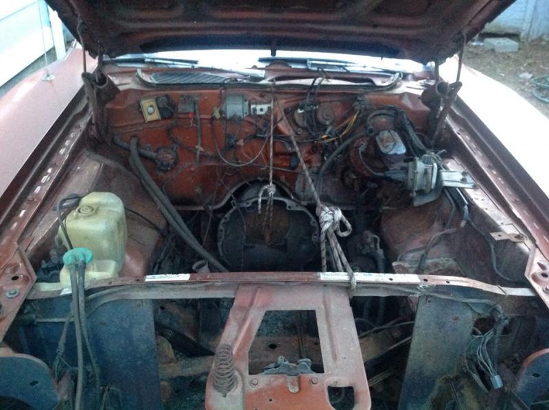

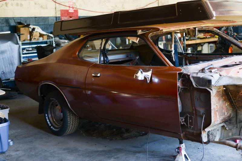

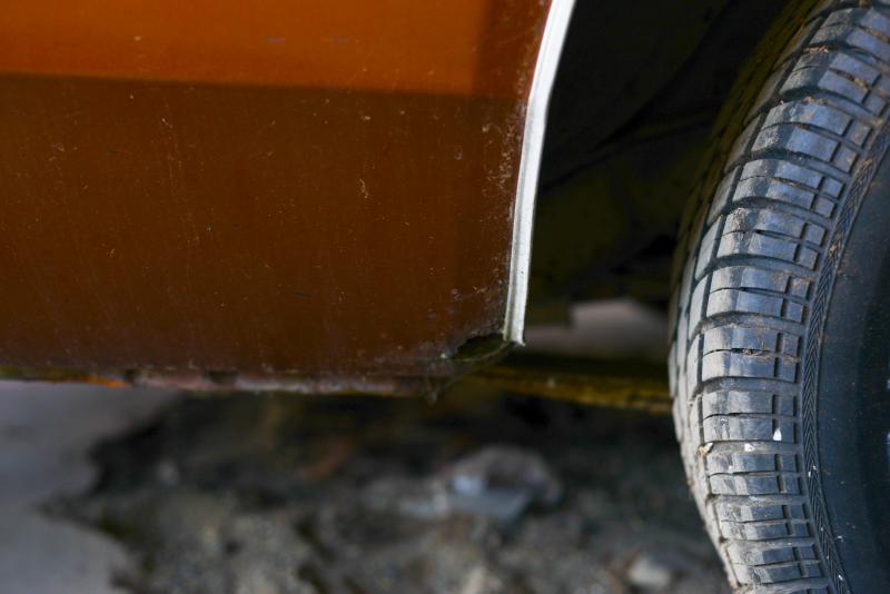

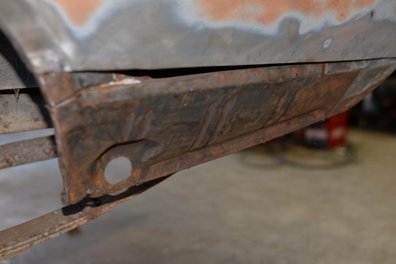

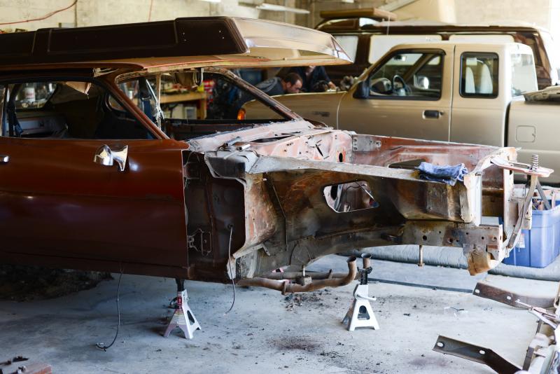

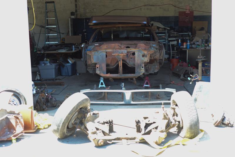

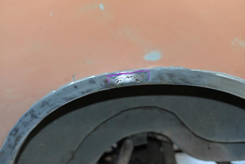

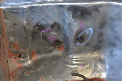

Moved the charger across town to a 5 bay shop where i will have more room to restore it. I stripped out the entire interior, windshield, and front suspension. i also included a pic of the only "serious" rust on this car. At the moment,

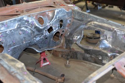

i am focusing on the front of the car, primarily the engine bay. current plan is to stip down the engine bay and fender well areas of the car so that i can weld all the seams in order to stiffen the chassis up some in an effort to make the car more rigid for handling improvements. i'll post up pictures of that process once i get into it :)

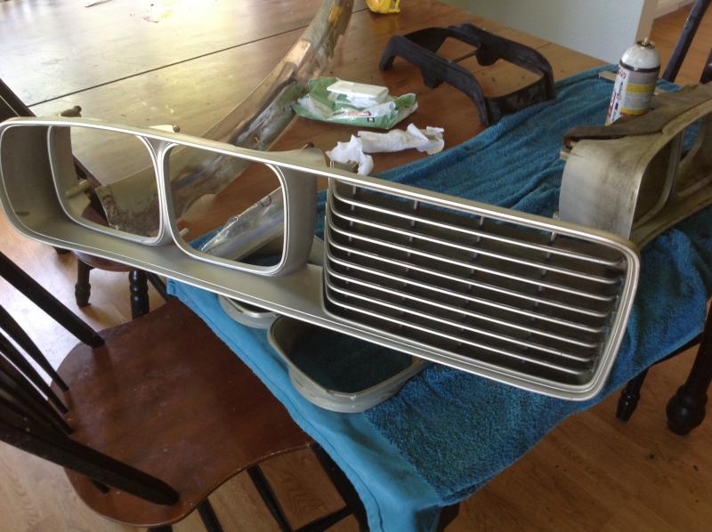

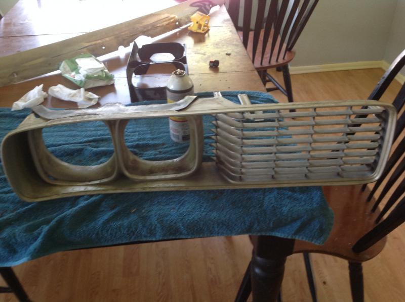

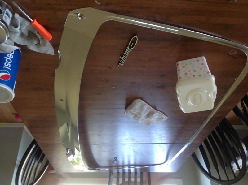

Happy fathers day to all my fellow mopar dads and grand-dads! small update...i have not made a lot of progress with the charger due to some family health issues, but that should be changing this week...i hope :p since i couldnt make it across town to work on the car, i brought the car to me...or at least pieces of it so i could make some headway while playing family doctor at home. i started sanding down and repairing the damaged spots in my grille halves and refinished them, polished the stainless outer window trim and drip rail pieces, and i am masking off my tail lamp lenses for refinishing (very tedious...) here are a few pics, i will snap some of the completed grilles once they dry,enjoy :)

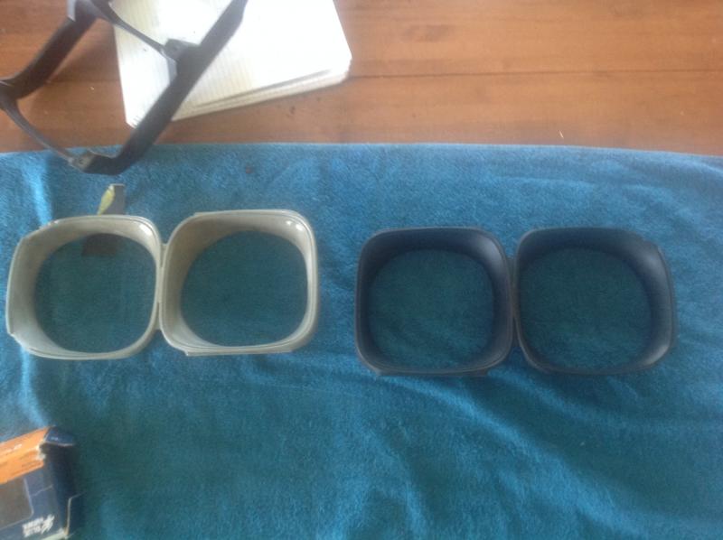

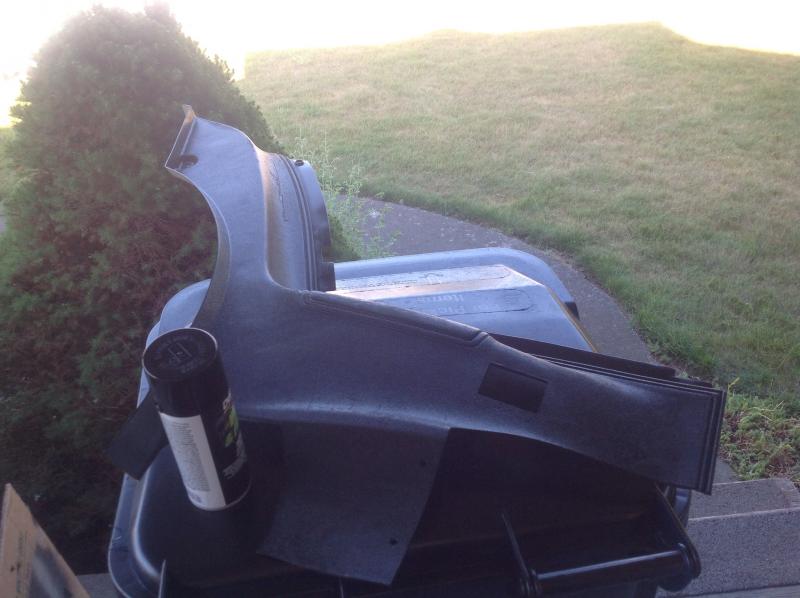

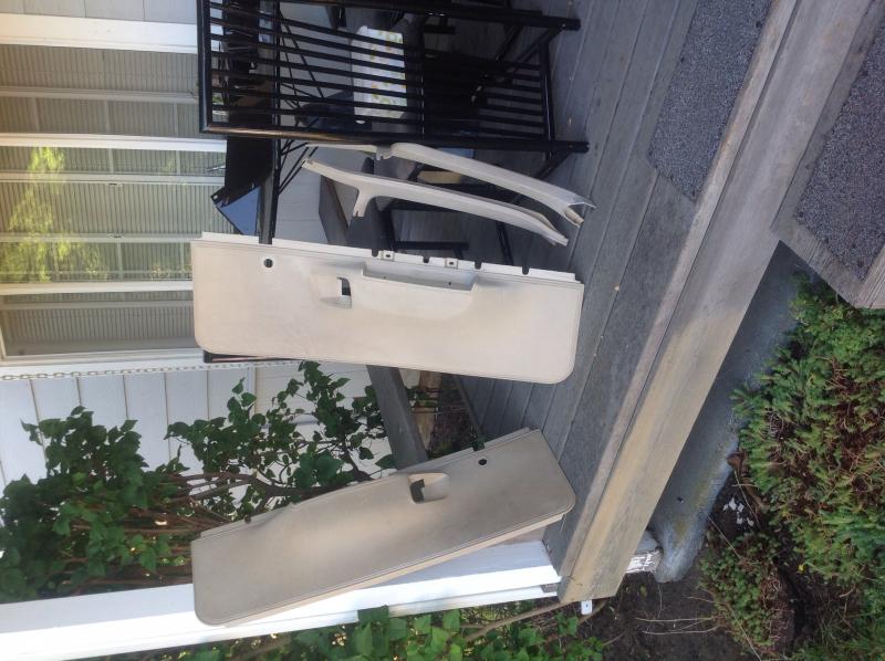

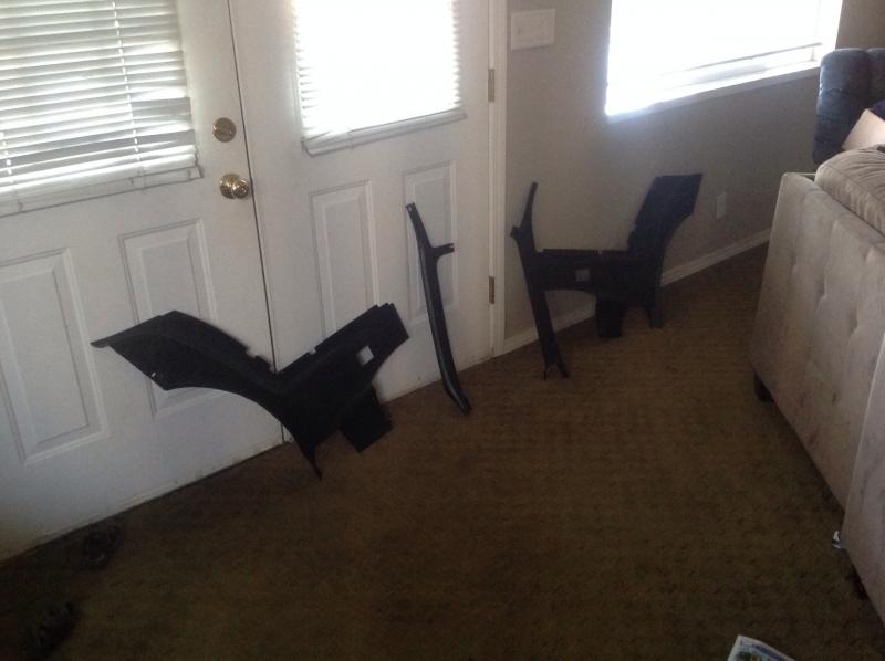

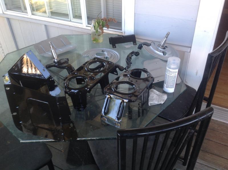

Got several of the small parts sandblasted and coated in por15. Also fully scrubbed my plastic interior panels and began spraying them with duplicolor adhesion promoter and then their gloss black interior spray paint/dye...turn out ok, we will see how they hold up over time. I will likely end up buyin all new black pieces, but for now with my budget and timeline, this will do for now....for anyone else going this route, be smarter than me and buy 2 cans of the adhesion promoter and 2 cans of the color paint...the panels soak up a ton of it and I ran out half way through :/

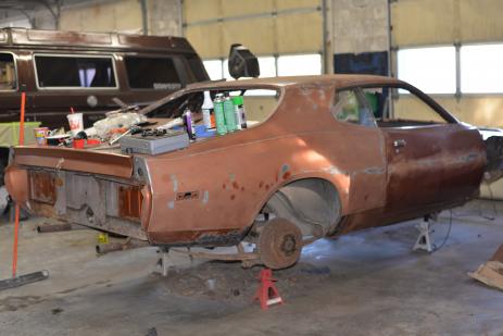

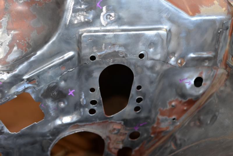

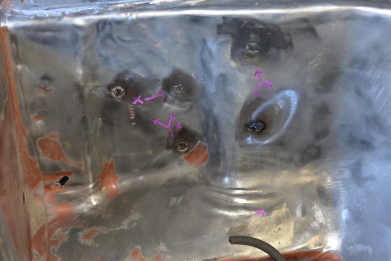

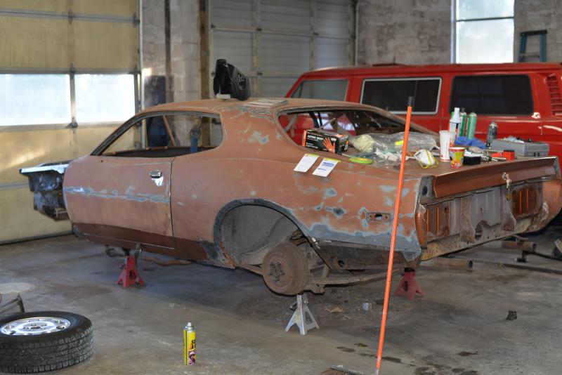

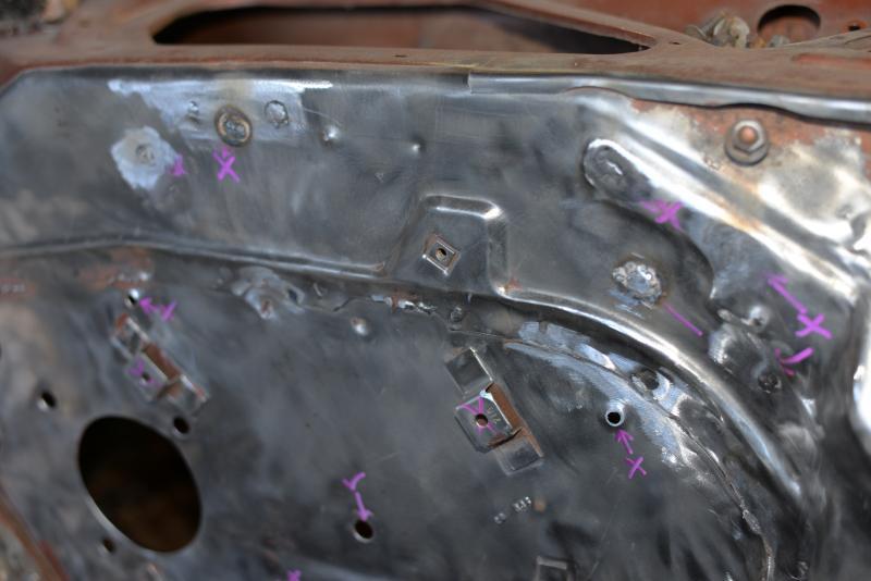

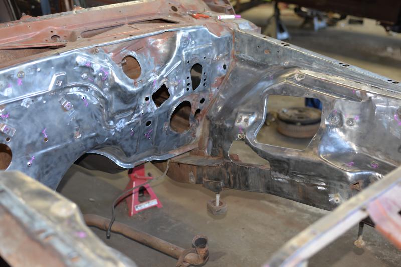

Small update; I have been working on the charger from time to time between family issues and working on everyone else's car's. Mainly i have been welding up unnecessary holes and openings in the engine bay and have removed the lower driver's side quarter panel for replacement. now that i have some free time to myself, i hope to make some headway on the charger! i have a metal fabricator helping my to make my own replacement panels, if we can pull it off, it will be a huge savings over buying the expensive tabco skins! i'll keep you guys posted :)charger6.jpgcharger7.jpgcharger8.jpgcharger9.jpgcharger10.jpgcharger11.jpgcharger12.jpgcharger13.jpgcharger14.jpg

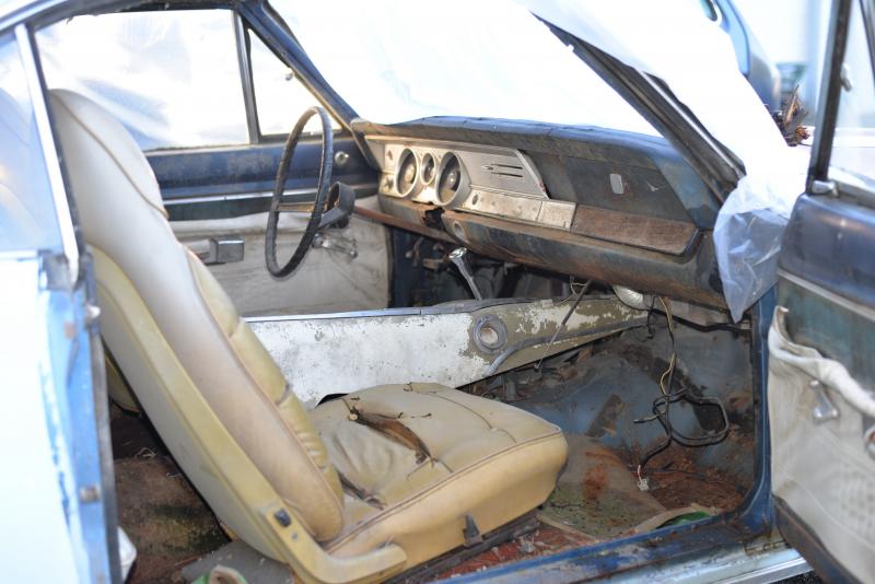

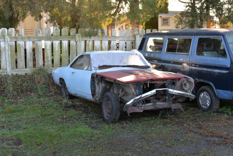

oh, i also scored a 1967 cuda coupe that came with what appears to be 1972'ish b-body buckets! so they will eventually find their way into the dodge!cuda1.jpgcuda2.jpgcuda3.jpgcuda4.jpg
