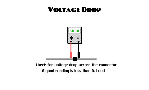

So how do you find these kinds of problems? You do a voltage drop test.
VOLTAGE DROP TEST
A voltage drop test is the only effective way to find excessive resistance in high amperage circuits. It's a quick and easytest that doesn't require any disassembly and will quickly show you whether or not you've got a good connection or a bad one.
To do a voltage drop test, you create a load in the circuit that's being tested. Then you use a digital volt meter (DVM) to measure the voltage drop across the live connection while it is under the load. Voltage always follows the path of least resistance, so if the circuit or connection being tested has too much resistance some of the voltage will flow through the DVM and create a voltage reading.
