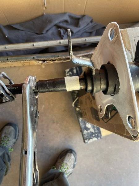

Was able to finally get to this today finishing off my other jobs. Pulled the column, marked my current position with tape and tapped out the 1/2 inch distance I needed. This should do it.
Thanks all for you support and patience with me on this one! Not fully understanding and having to learn how this part of the column works takes a bit of time.
Hopefully this will help others in the future as well!

It’s all sorted out yes.It was the original column. It got compressed but I only have theories as to why. I was able to tap with some vigor the shaft back out. Turns out it needed to get to full extension to line up correctly. Not sure if full extension was limited to the plastic shear stops/pins or some internal ring stop I haven’t a clue. But it’s perfect now!
