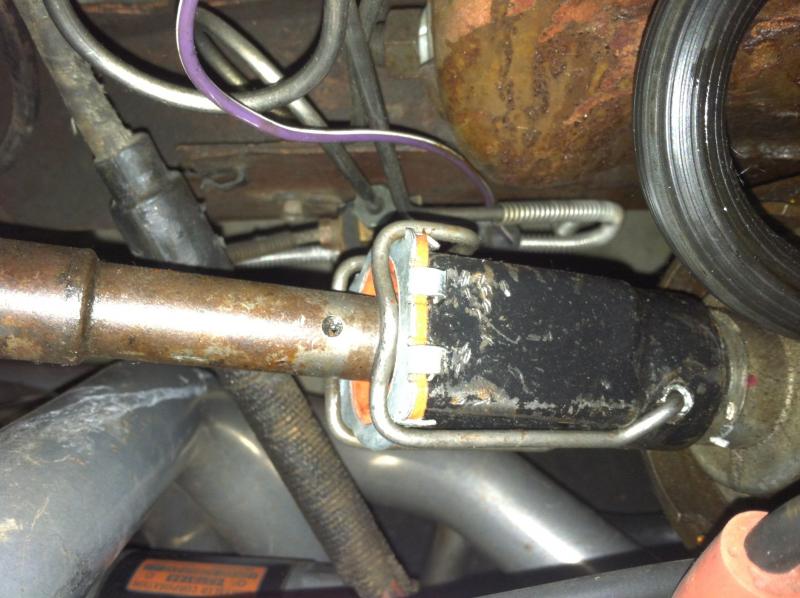

That's a good one. Years ago Chrysler had a TSB on that and it called for a spring steel clip that actually wrapped over the retainer and ended in the roll pin ends. As far as I know they are no unobtainable. I think there are aftermarket boot type covers for the coupling.
This ones mine. Wish I had more.

I might have to make something like that. Those little tangs on the coupler flange don't hold that well....especially after the column has been in and out many times over the years.

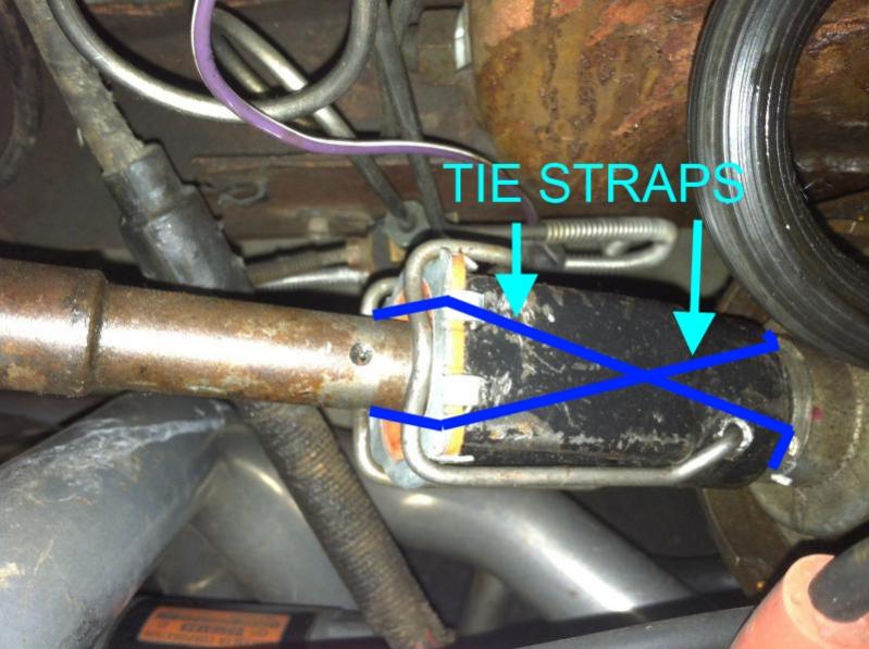

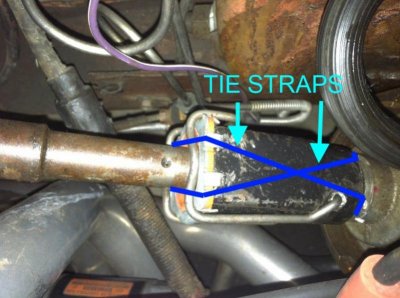

Take a two long nylon tie straps (or a couple shorter ones banded together), tighten them diagonally across the coupler to hold the retainer and seal tight against the coupler. Take a hammer and small punch and flatten the little tangs down just past the little holding tabs on the coupler. Turn the wheel to access all sides and cut the tie straps when done. Best way I've found to do it.
...and just a reminder to everyone....don't go beating too hard with hammers on the steering column. That is a great way to damage seals etc.
