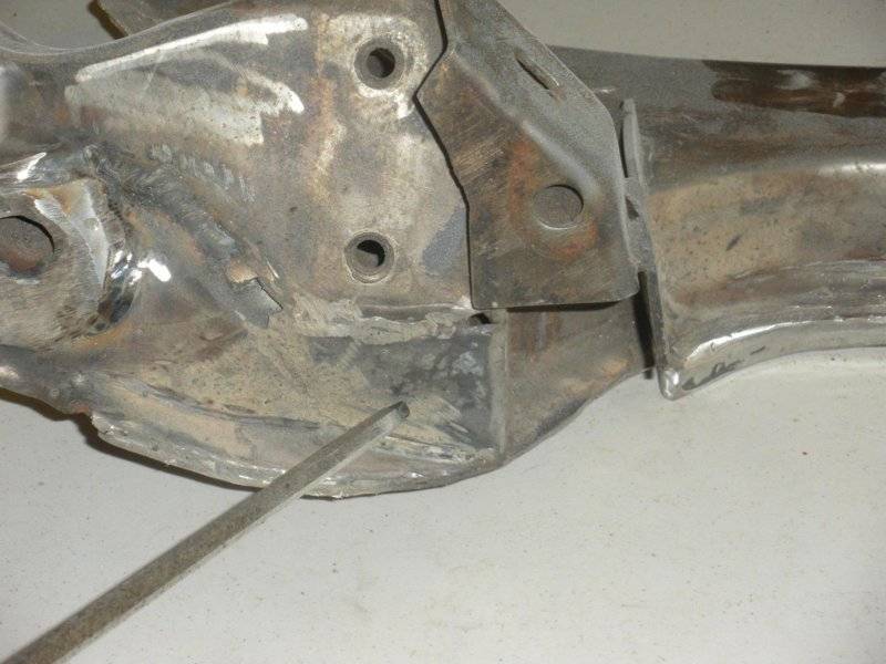

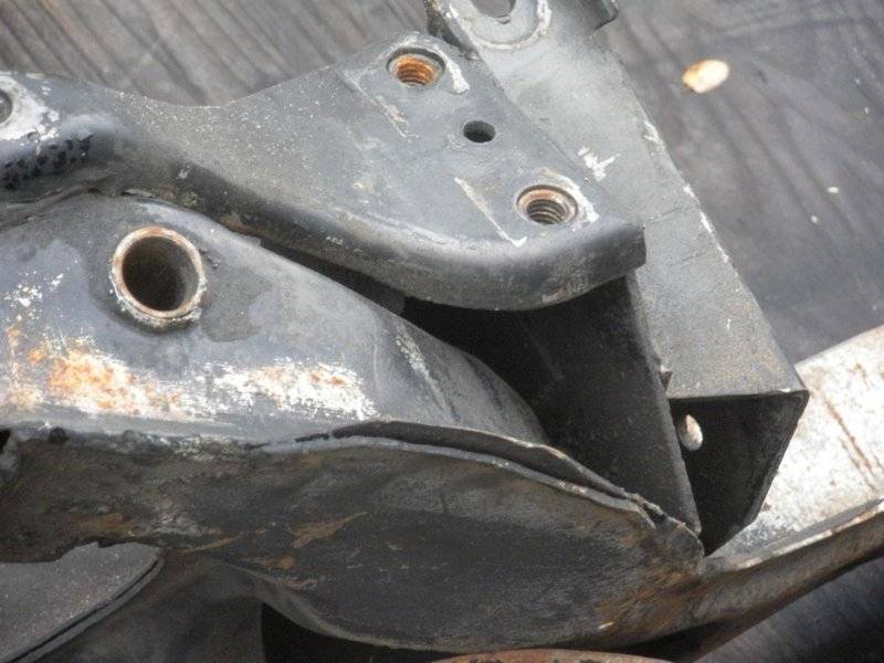

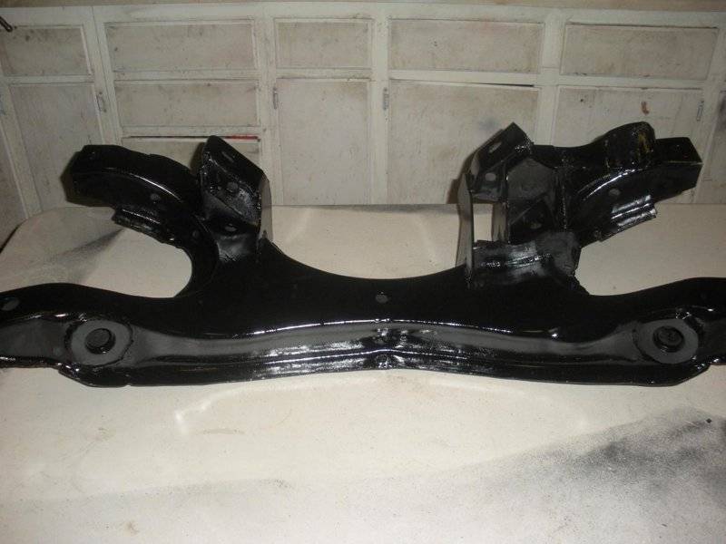

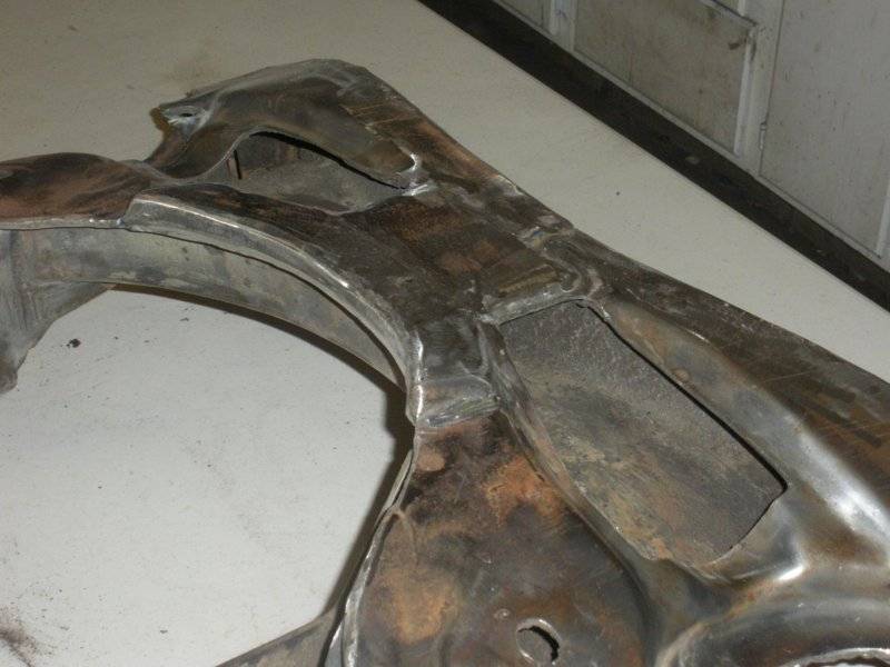

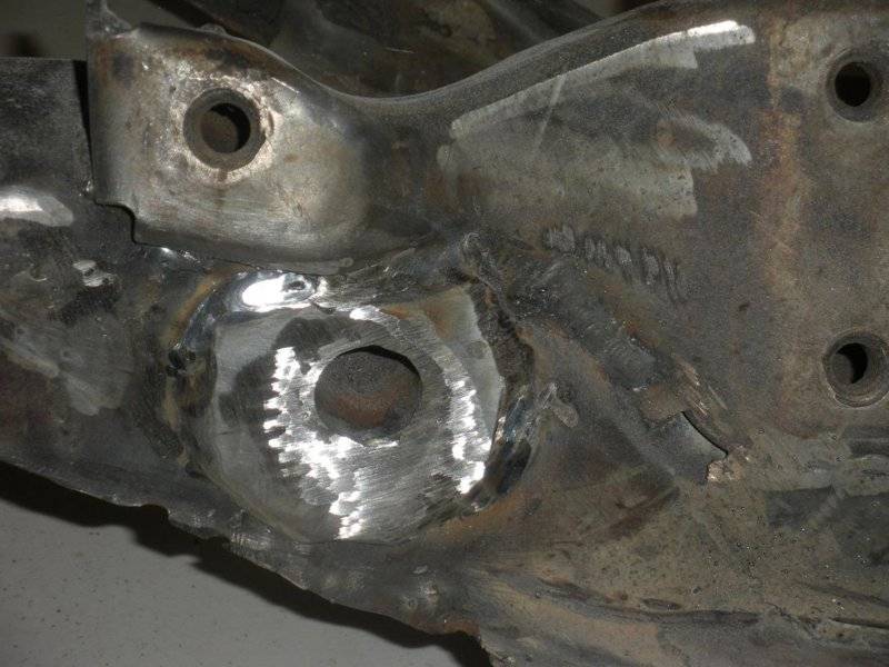

This is the K member:
The triangle metal file is pointing where reinforcement plates filled in where the factory left it open.
The two threaded holes are 2 of the 3 steering box mounting holes.
In a stock unmodified car with wide tires, you can let the car run and have a helper move the steering side to side. While the wheels are turning, you can look under the hood at the steering box move side to side as well because the stock steering box mounting brackets flex. With skinny tires they won't move as much but with wider tires they will. Welding in the reinforcements really cuts down on flexing here and improves steering precision.
That's a genius little idea you got there, doesn't seem like too hard of a job considering the other junk I've had to deal with on this car...thanks for the tip! Do you do this to all your cars?

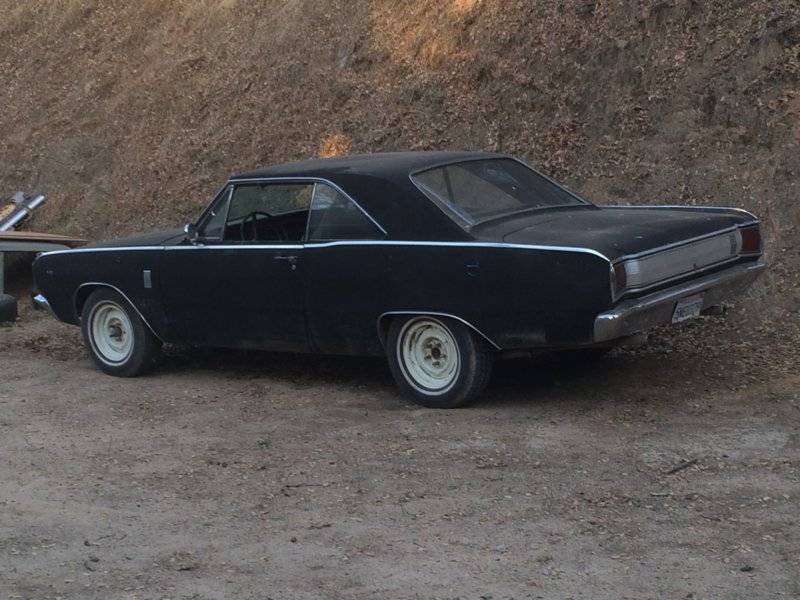

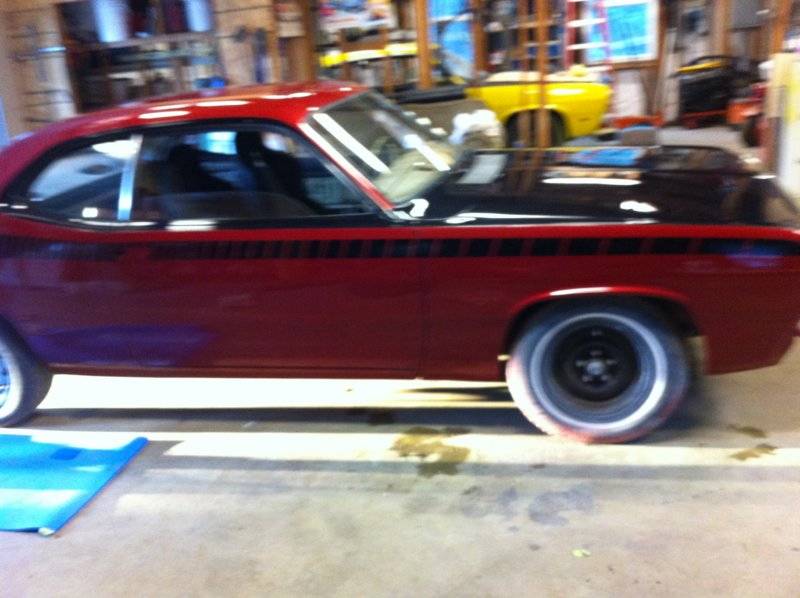

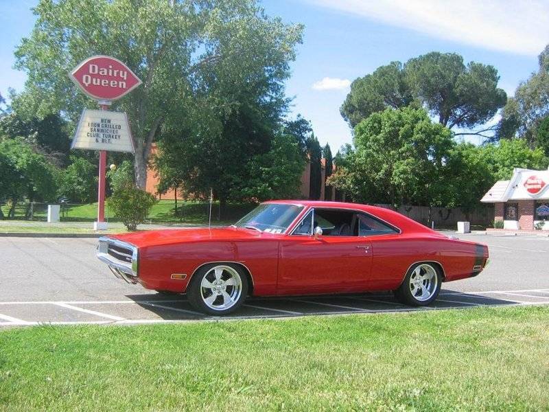

I have done it 4 or 5 times. I did it for this car:
This car:
This car:
My beater '67 Dart:
AND my keeper:

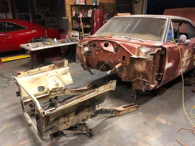

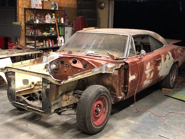

I just welded in a new front structure to this car:
And it too will get a welded and reinforced K member. The cost is minimal but the gains are huge.
